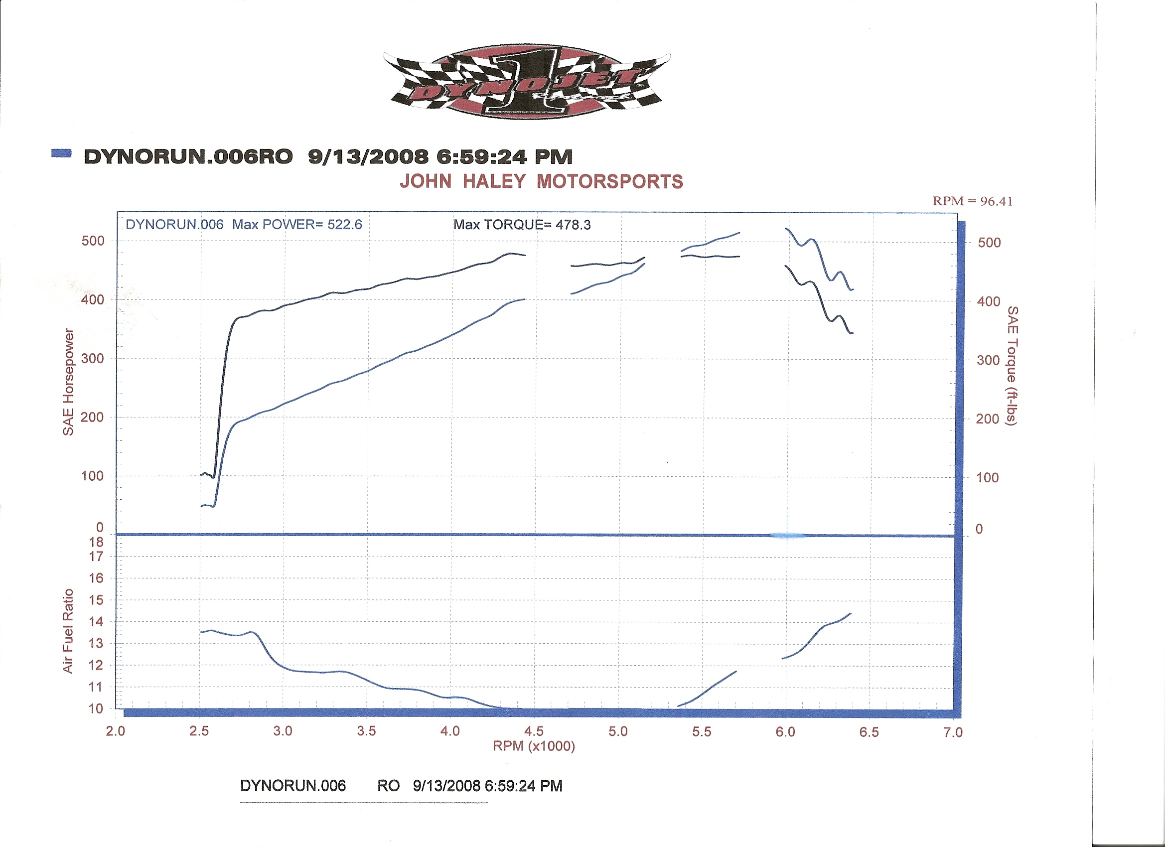

<?xml version="1.0" encoding="UTF-8"?><rss xmlns:dc="http://purl.org/dc/elements/1.1/" xmlns:content="http://purl.org/rss/1.0/modules/content/" xmlns:atom="http://www.w3.org/2005/Atom" version="2.0"><channel><title><![CDATA[Dyno time yesterday]]></title><description><![CDATA[<p dir="auto">So we had a get together saturday and dyno time was cheap.  I made 8 pulls mostly just to see what the fuel was doing.  Started off at 390hp 440tq, the car was so rich it wouldnt go over 4k it would just miss and sputter.  I wound up pulling a shitload of fuel out everywhere but the A/F curve is still seriously fuxored.  Beleive it or not, that is way better than i started with.  I was picking up 20-30whp per pull when my blower belt took a shit and ripped a heater hose off the water pump.  Here was the results, maximum of about 13psi, when it drops over 6k thats when it shit the bed.<br />
522whp<br />
478wtq</p>

<p dir="auto">when u get that a/f leaned out you should gain some good #'s</p>
