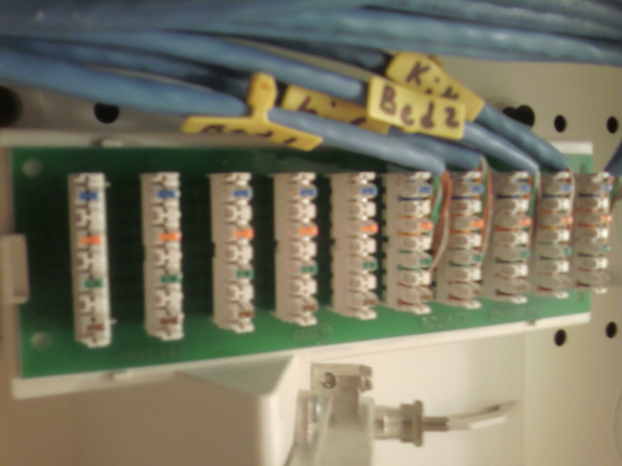

<p dir="auto">Attached is a photo of were the cabling box...</p>
<p dir="auto">I see position 0 runs to a wire that goes outside my townhome in to the attached building, I want to just be able to run LAN stuff over the prewired stuff.</p>
<p dir="auto">So do I yank the wires out of that splitter thing, put cable ends on them and plug them into my router?  Or do I split a wire plug it into position 0 and can run data over it (I have a feeling this is not the case, as it just looks daisy chained).</p>

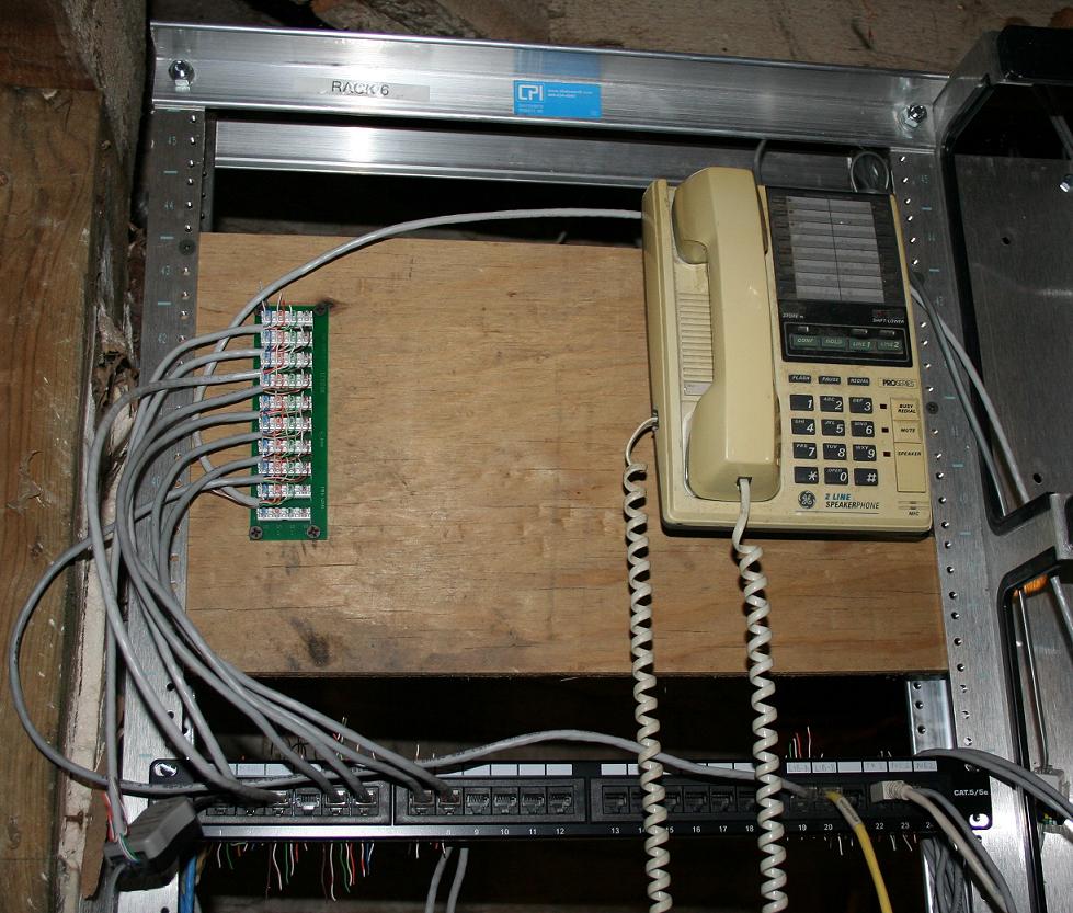

<p dir="auto">The peice of plywood screwed into the top of the rack is what i mounted the bus-bar [what jim has] and a dorky old telephone to.</p>
<p dir="auto">the bus bar is for voice phones in the house.</p>
<p dir="auto">My main building entrance for phone is remoted over to port 1 on the black patch panel.  Plugged into that is the only DSL splitter I have - one side goes to my DSL modem, the other goes to the short patch cable that goes to position 0 [the top most] on the bus block.</p>
<p dir="auto">All [except 1] of the other short patch cables coming off the bus block go back to the patch panel and "create" the various phone jacks in the house.</p>
<p dir="auto">The bottom most wire coming off of the bus block has a 6p6c/rj11 [i don't remember] female connector on it just to the right of the patch panel.  The nasty 20 year old GE phone plugs into that.  It's handy to have a test phone and a valid phone jack in your wiring closet [although mine is a "wiring basement"].</p>
<p dir="auto">all of my actual network and server equipment is sitting on a table next to the rack because i am ghetto and have not converted over all of my stuff to rack-mountable yet.  I run wired gig-E in the house, with active ports for my wife's office, my library, my theater room, and i don't remember where else.  I only use wireless for devices that move, i.e. laptops.</p>
<p dir="auto">If at some point, I want the phone jacks to be data [i.e. VOIP handsets inside the house], i just unplug the patch cables from the black panel to the bus block, and instead run a cable from that patch panel port over to a network switch.  This also lets me convert one phone jack at a time, i.e. if i were running a hybrid POTS/VoIP system in the house [like asterisk PBX or something], some extensions could be old analog phones and some could be IP phones.</p>
<p dir="auto">the patch panel i got off of newegg,the bus block at home depot.  the RJ45 ends and jacks and wall plates and other stuff are all leviton and you can get them from home depot.  The reason that none of the punched-down wire endss are cut is because i don't even have a real punchdown tool, i've been using the plastic one leviton includes with all of their stuff <img src="https://fargostreet.com/assets/plugins/nodebb-plugin-emoji/emoji/android/1f642.png?v=40430adaedb" class="not-responsive emoji emoji-android emoji--slightly_smiling_face" style="height:23px;width:auto;vertical-align:middle" title=":)" alt="🙂" /></p>

<p dir="auto">I'd also change it so that the incoming line into the house doesn't go directly to the bus block.  This way if you [or someone else] ever wants to run DSL, they put in one line-filter at the wiring panel and no filters are required anywhere in the house.</p>
<p dir="auto">if you do the wiring right at both ends, you may be able to stack voice and data over the same cat5, but that limits how fast of a network you can run.  you'd be better off doing voip in that case and running native data.</p>
<p dir="auto">the reason to do the patch approach is so that you can flip everything back to "phone only" when you go to sell the place just by unplugging a few things.</p>

<p dir="auto">Patch Panel that accepts keystone jacks.  Crimp keystone jack on end of every cable run.  Run patch cords from panel to router/switch.</p>
<p dir="auto">The cheap route would just be remove the jacks and crimp RJ45 ends on each cable and plug directly in to the router or switch.</p>
