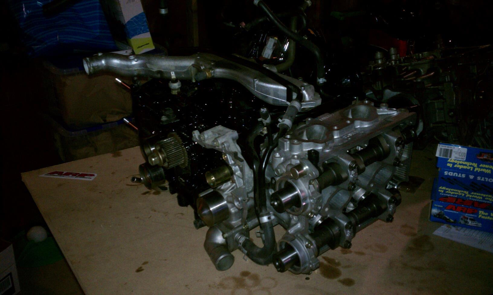

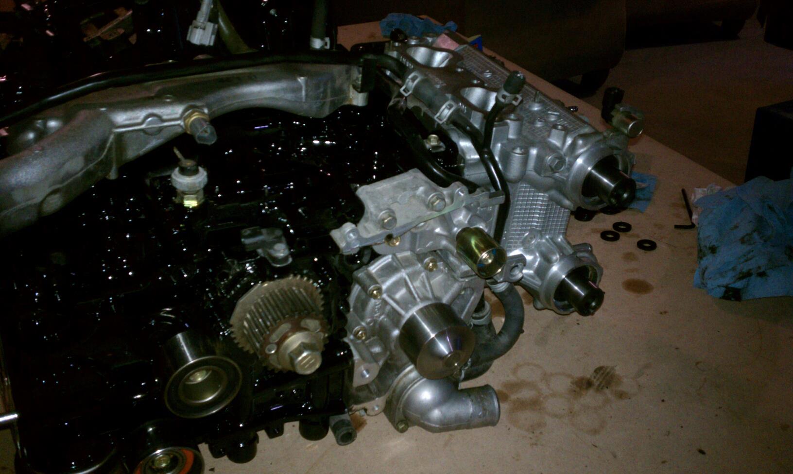

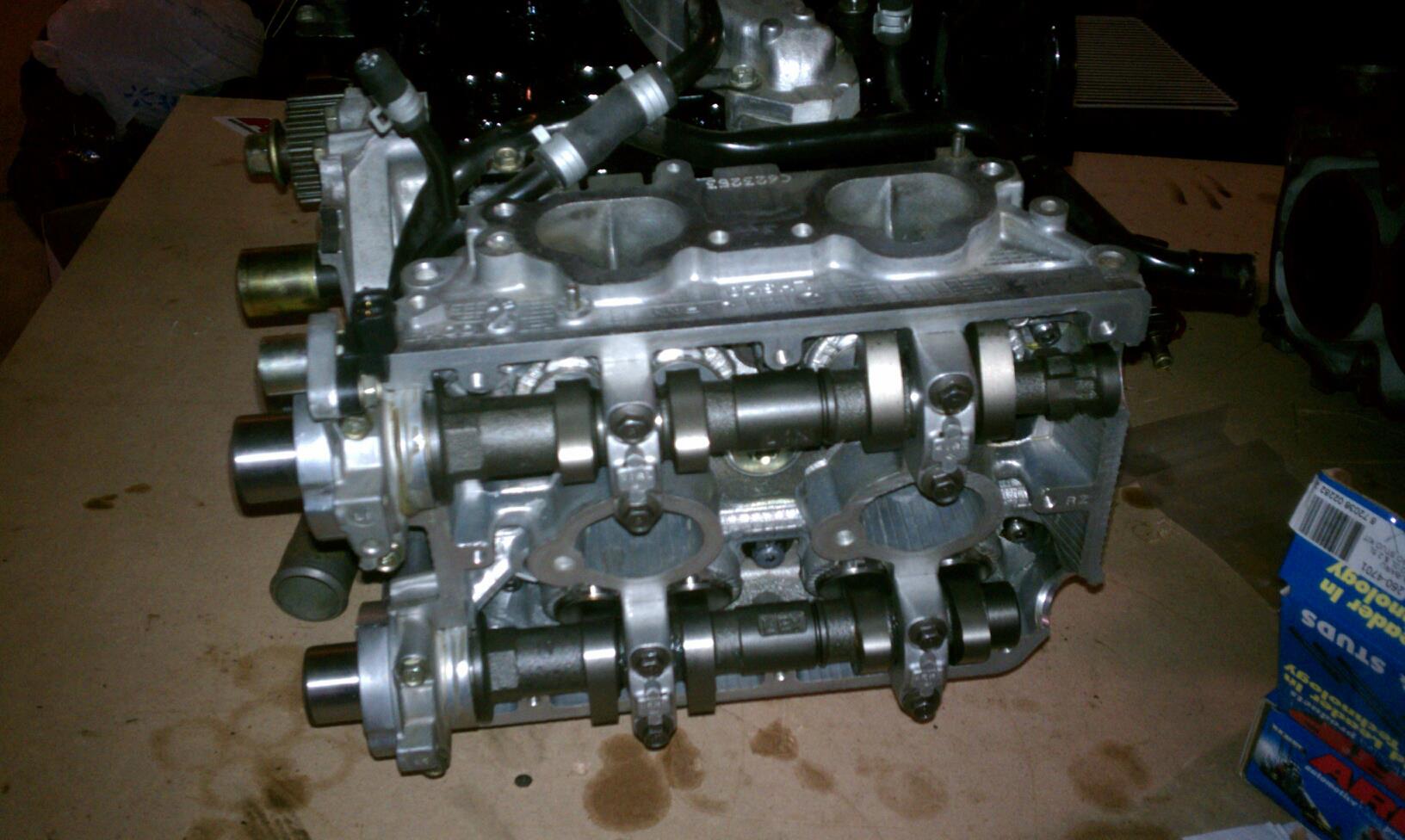

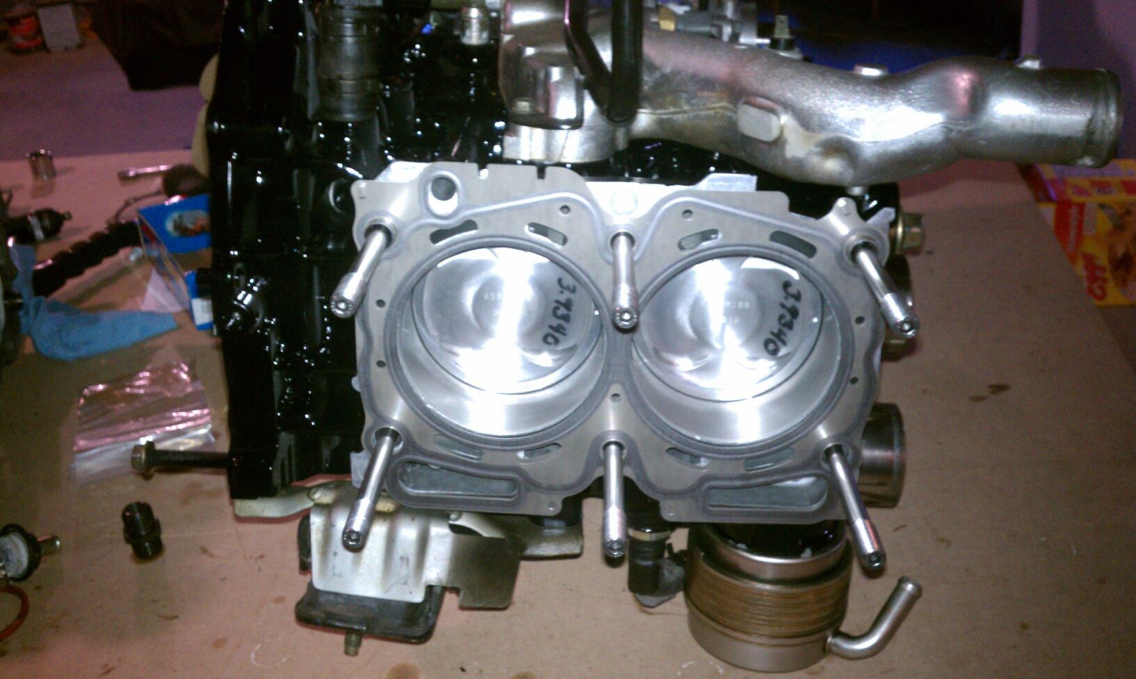

<?xml version="1.0" encoding="UTF-8"?><rss xmlns:dc="http://purl.org/dc/elements/1.1/" xmlns:content="http://purl.org/rss/1.0/modules/content/" xmlns:atom="http://www.w3.org/2005/Atom" version="2.0"><channel><title><![CDATA[Finally some progress on my WRX]]></title><description><![CDATA[<p dir="auto">As most of you know, I blew my EJ20 a couple of years back and had been working on building my new motor.  I'm getting close to being done finally and am working on the assembly (some things have changed since I my original setup ideas...):</p>
<p dir="auto">EJ257 block bored to 100mm<br />
Brian Crower Stroker Crank<br />
Eagle Rods (custom ordered to work with stroker crank)<br />
Wiseco Pistons<br />
FIC 2150 Injectors (ordered, but not received yet)<br />
Kelford 286* cams<br />
Brian Crower Springs &amp; Retainers<br />
P&amp;P EJ20 Heads (kept them for their smaller quench area/higher compression)<br />
Dual Walbro fuel pumps<br />
Boomba Fuel Rails<br />
PT6262 Billet turbo<br />
ZEX wet kit (probably a 100 shot...but we'll see)<br />
TGV Deletes<br />
along with everything I had before I tore the motor out.</p>
<p dir="auto">Still debating on diff's, axles, driveshafts, coil overs and a few other odds and ends.</p>
<p dir="auto">Big thanks to Jason Kellen, for his awesome paintjob on the block, Weshole for his accent painting on the other items, FujiK for his head work, Elroy @ Subaru for assembling the head after the P&amp;P, my wife Jolien for letting me build an engine in the basement of our house, Stephen Bradley for demanding that we finally work on this thing and get it together, Shawn Jacob for letting me use his engine stand, Kevin Smith for letting me borrow his engine lift, and everyone else who has helped out along the way.</p>
<p dir="auto"><img src="/assets/uploads/legacy/attachments/6752/290608_10150338585407817_630242816_8092726_1936431809_o.jpg" alt="290608_10150338585407817_630242816_8092726_1936431809_o.jpg" class=" img-fluid img-markdown" /><br />
<img src="/assets/uploads/legacy/attachments/6753/323415_10150338585712817_630242816_8092727_1048726247_o.jpg" alt="323415_10150338585712817_630242816_8092727_1048726247_o.jpg" class=" img-fluid img-markdown" /><br />
<img src="/assets/uploads/legacy/attachments/6754/339743_10150338586022817_630242816_8092729_369803288_o.jpg" alt="339743_10150338586022817_630242816_8092729_369803288_o.jpg" class=" img-fluid img-markdown" /><br />
<img src="/assets/uploads/legacy/attachments/6755/286916_10150338586197817_630242816_8092730_372682375_o.jpg" alt="286916_10150338586197817_630242816_8092730_372682375_o.jpg" class=" img-fluid img-markdown" /></p>
