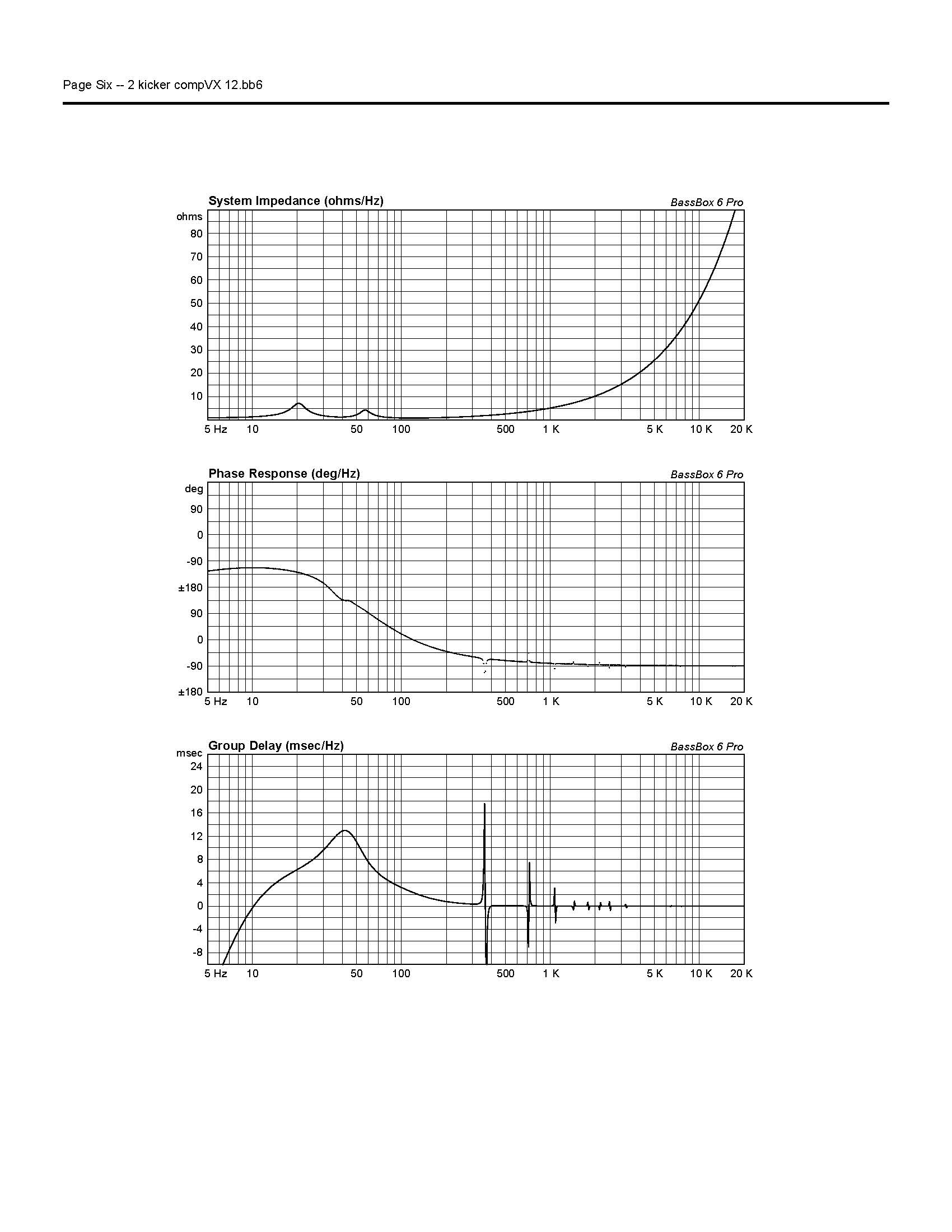

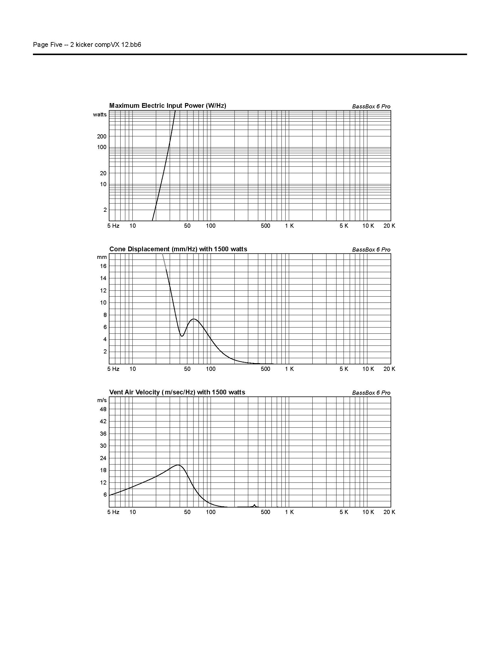

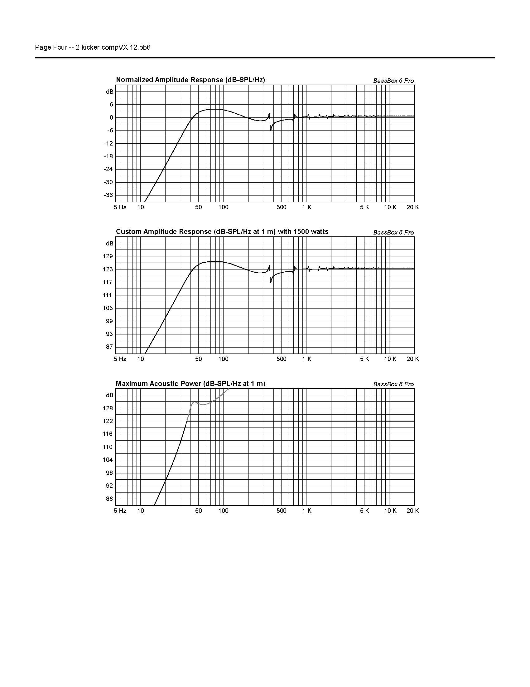

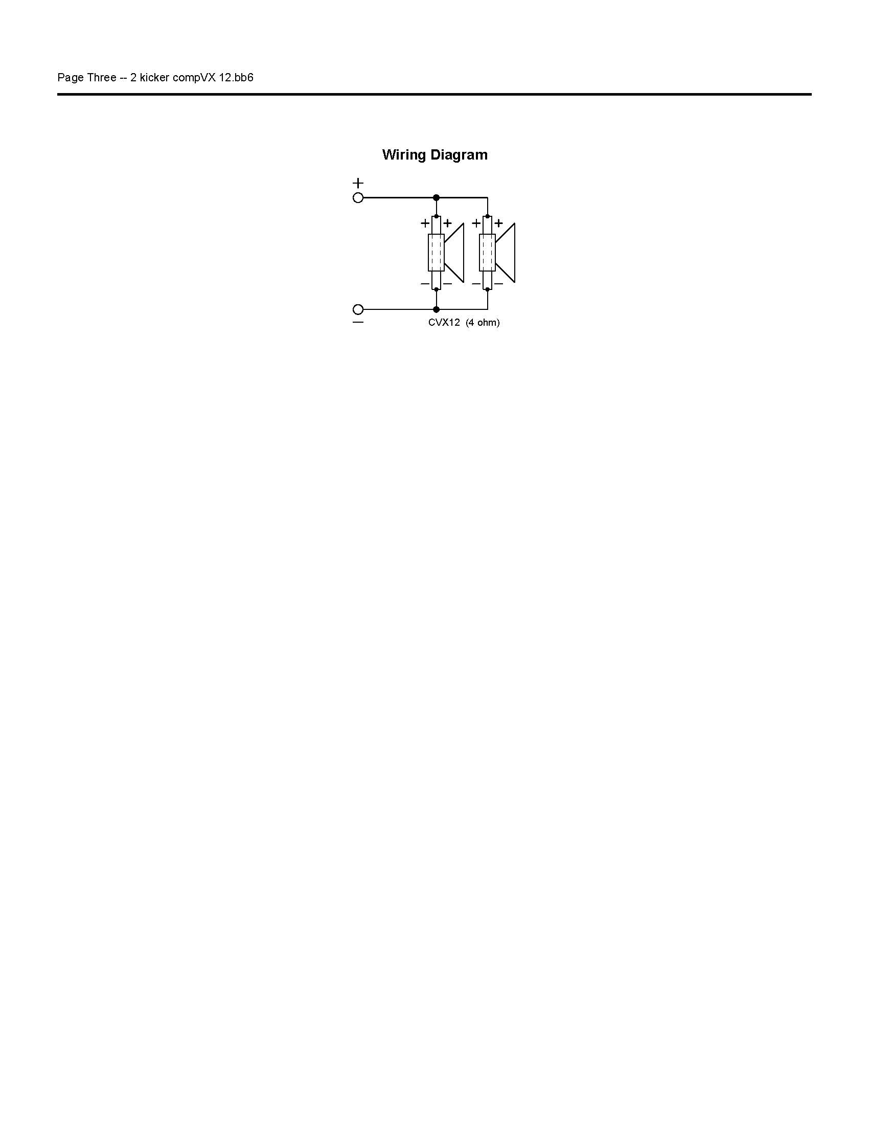

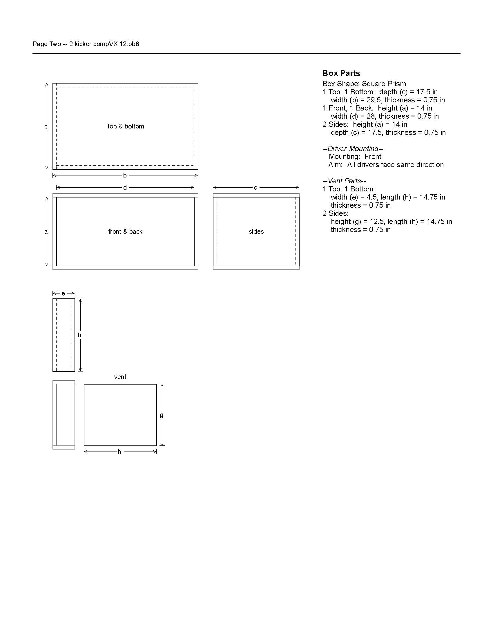

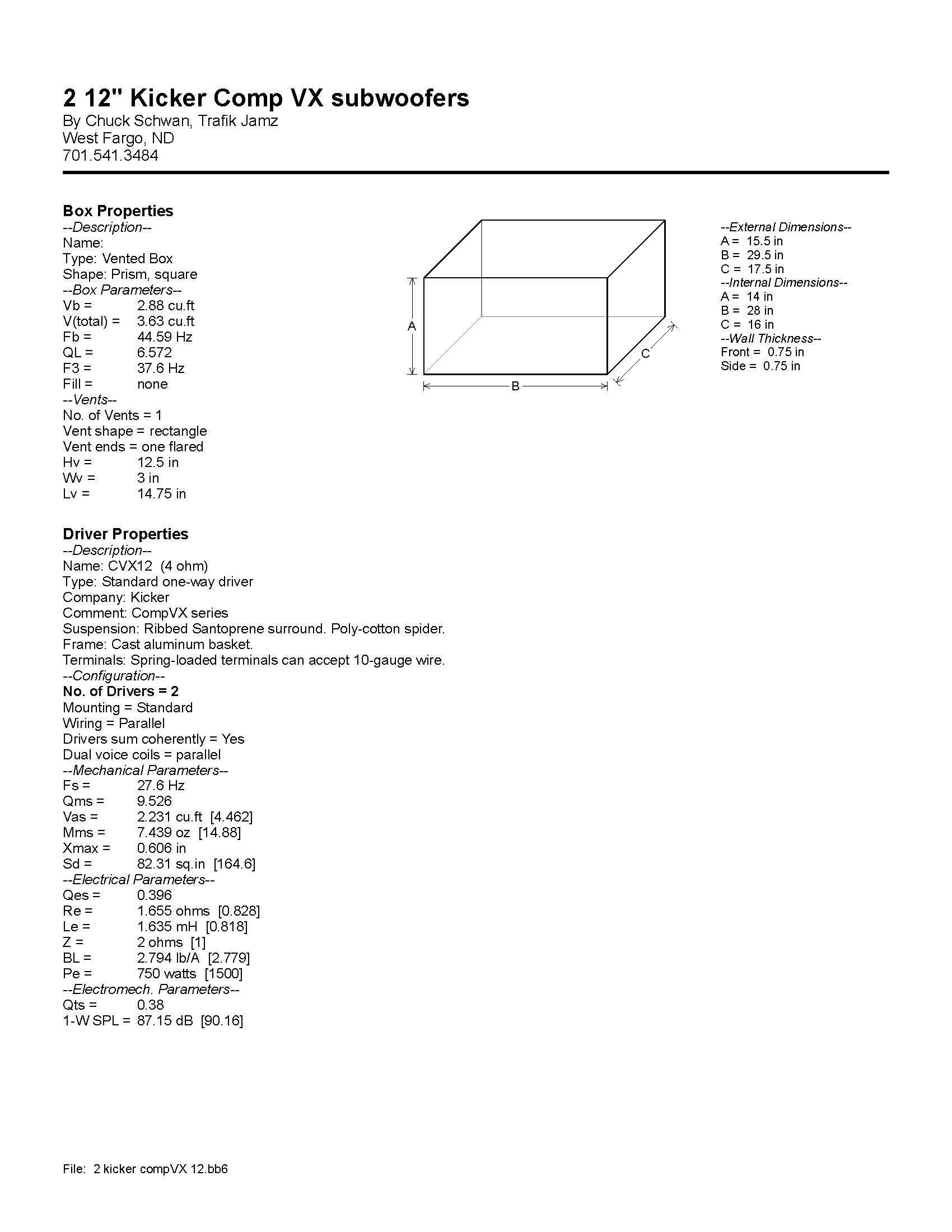

<p dir="auto"><img src="http://i14.photobucket.com/albums/a333/tjamz/Kicker12CompVX_Page_1.jpg" alt="legacy image" class=" img-fluid img-markdown" /><br />
<img src="http://i14.photobucket.com/albums/a333/tjamz/Kicker12CompVX_Page_2.jpg" alt="legacy image" class=" img-fluid img-markdown" /><br />
<img src="http://i14.photobucket.com/albums/a333/tjamz/Kicker12CompVX_Page_3.jpg" alt="legacy image" class=" img-fluid img-markdown" /><br />
<img src="http://i14.photobucket.com/albums/a333/tjamz/Kicker12CompVX_Page_4.jpg" alt="legacy image" class=" img-fluid img-markdown" /><br />
<img src="http://i14.photobucket.com/albums/a333/tjamz/Kicker12CompVX_Page_5.jpg" alt="legacy image" class=" img-fluid img-markdown" /><br />
<img src="http://i14.photobucket.com/albums/a333/tjamz/Kicker12CompVX_Page_6.jpg" alt="legacy image" class=" img-fluid img-markdown" /></p>
<p dir="auto"><img src="/assets/uploads/legacy/attachments/6809/Kicker%2012%20CompVX_Page_1.jpg" alt="Kicker 12 CompVX_Page_1.jpg" class=" img-fluid img-markdown" /><br />
<img src="/assets/uploads/legacy/attachments/6810/Kicker%2012%20CompVX_Page_5.jpg" alt="Kicker 12 CompVX_Page_5.jpg" class=" img-fluid img-markdown" /><br />
<img src="/assets/uploads/legacy/attachments/6811/Kicker%2012%20CompVX_Page_4.jpg" alt="Kicker 12 CompVX_Page_4.jpg" class=" img-fluid img-markdown" /><br />
<img src="/assets/uploads/legacy/attachments/6812/Kicker%2012%20CompVX_Page_2.jpg" alt="Kicker 12 CompVX_Page_2.jpg" class=" img-fluid img-markdown" /><br />
<img src="/assets/uploads/legacy/attachments/6813/Kicker%2012%20CompVX_Page_3.jpg" alt="Kicker 12 CompVX_Page_3.jpg" class=" img-fluid img-markdown" /><br />
<img src="/assets/uploads/legacy/attachments/6814/Kicker%2012%20CompVX_Page_6.jpg" alt="Kicker 12 CompVX_Page_6.jpg" class=" img-fluid img-markdown" /></p>
