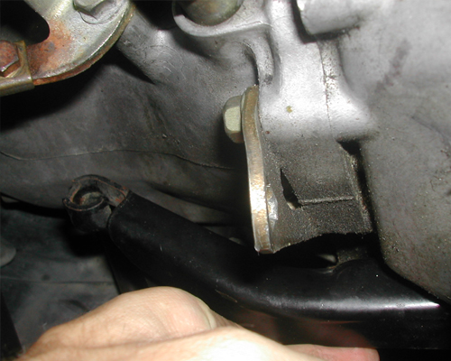

<p dir="auto">The arm at this point was only traveling a 1/2 inch or so, and the pedal assembly was taking the rest of the travel. So my clutch pedal broke off the assembly. After fixing that I took everything else appart, and I can't figure out what is wrong?</p>
<p dir="auto">Nothing is broke, nothing looks bent. The engine/clutch/mounts don't even have a oil change on them..</p>

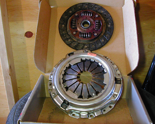

<p dir="auto">The only thing I found that was weird is that I ended up getting the wrong size clutch, it was for the larger imput shaft spir size. however it was close enough to work, and I also tryed the stock clutch and same problem. it's like that arm has WAY to much free play?</p>
<p dir="auto">Today I installed a new cable tranny.  The same problem, the TOB still has to travel too far to contact the pressure plate.. I am going crazy &amp; loosing hope. Back to ground zero.  Anyone have any idea's or know what might be going on?</p>

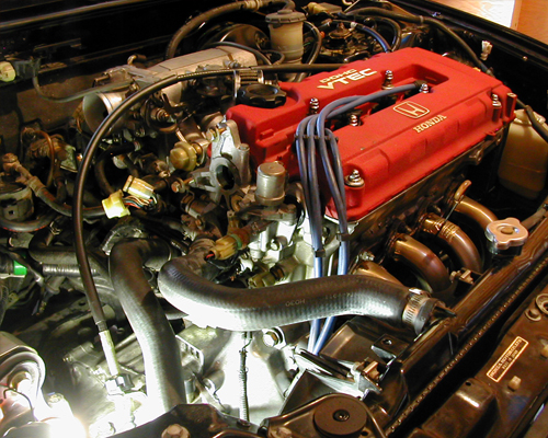

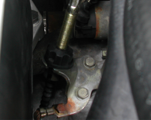

<p dir="auto">Pictures of my car, and some up to date pictures of how it sits.</p>
<p dir="auto"><img src="/assets/uploads/legacy/attachments/3192/28tp8.jpg" alt="28tp8.jpg" class=" img-fluid img-markdown" /><br />
<img src="/assets/uploads/legacy/attachments/3193/29ph2.jpg" alt="29ph2.jpg" class=" img-fluid img-markdown" /><br />
<img src="/assets/uploads/legacy/attachments/3824/clutchmovement2ji4.jpg" alt="clutchmovement2ji4.jpg" class=" img-fluid img-markdown" /><br />
<img src="/assets/uploads/legacy/attachments/3825/crx1dc8.jpg" alt="crx1dc8.jpg" class=" img-fluid img-markdown" /><br />
<img src="/assets/uploads/legacy/attachments/3826/crx2ph1.jpg" alt="crx2ph1.jpg" class=" img-fluid img-markdown" /><br />
<img src="/assets/uploads/legacy/attachments/3827/crx3ib3.jpg" alt="crx3ib3.jpg" class=" img-fluid img-markdown" /><br />
<img src="/assets/uploads/legacy/attachments/3828/engineshotea9.jpg" alt="engineshotea9.jpg" class=" img-fluid img-markdown" /><br />
<img src="/assets/uploads/legacy/attachments/3829/untitled1copyvr2.jpg" alt="untitled1copyvr2.jpg" class=" img-fluid img-markdown" /></p>

<p dir="auto">The pedal assembly turned out to be the problem.  It kept bending from my Exedy cable cutch untill it broke.  Then when I got it back together my starter went out, so I got a new starter in it.</p>

How much free play is there in the lever arm before you feel the throwout bearing touch the pressure plate?<br />
3/4th's play 1/4th engauglement.  And that is what is wrong with the car, wayyy to much play.</p>

I compaired the lenghts, it did not strech.  I have only replaced the assembly once, and if I have to do it again I'm going to murder puppies.  That was not easy to find or replace.</p>
<p dir="auto">The problem is with the travel of the arm, not the cable. The cable is doing it's job.  I tried a used 100% stock clutch/PP, and had the same problem with TOB travel.</p>
