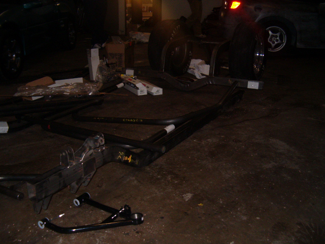

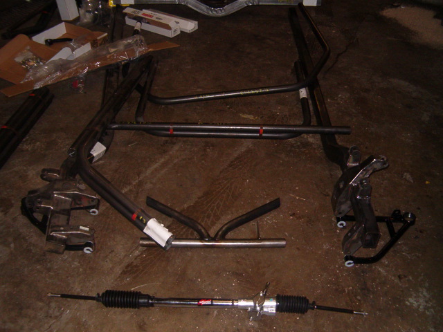

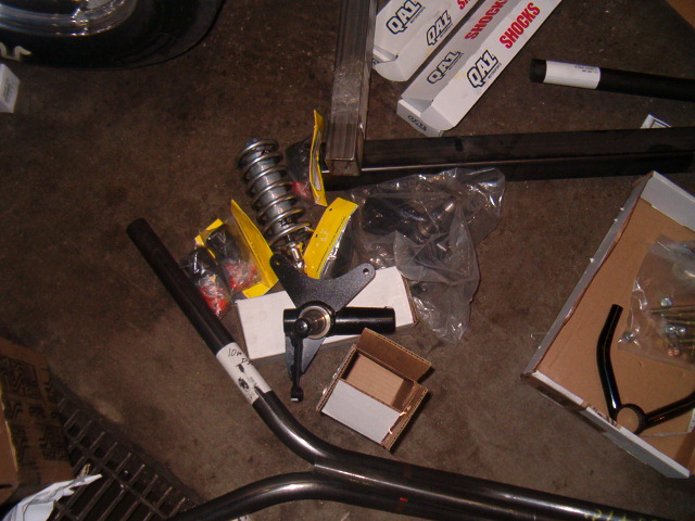

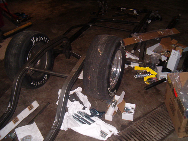

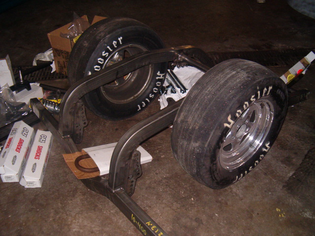

    Cages and Kevin's chassis showed up last week. Time for his lazy ASS to get to work!!

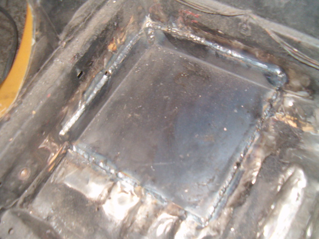

        Started on mine over the weekend. Ended up going w/ a much larger floor plate w/ a 1.5" broke edge due to the fact that the Honda floor boards were so weak they didn't even support the 6"x6" w/o letting go. Gonna be much stronger this way as im gonna weld the plate from the bottom side to the rocker panels as well and i have a much flatter surface for the main hood now as well.
