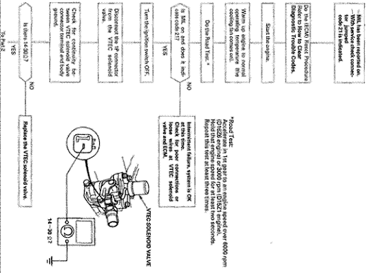

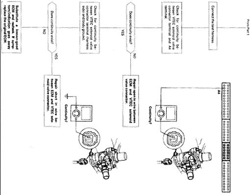

                      • ticklemedalyT Offline
                        ticklemedaly
                        Here is a diagnostic aid. hope it helps.
                        XBL G-tag: TickleMeDaly83
                        • harwood39H Offline
                          harwood39H Offline
                          harwood39
                          i think it shorted when i was rewiring the ecu after disconnecting the VAFC. Wiring is fine, checked it. Its the solenoid.
