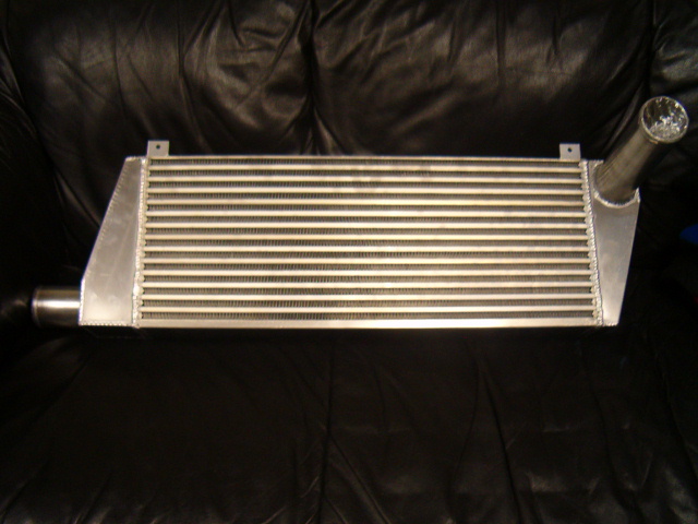

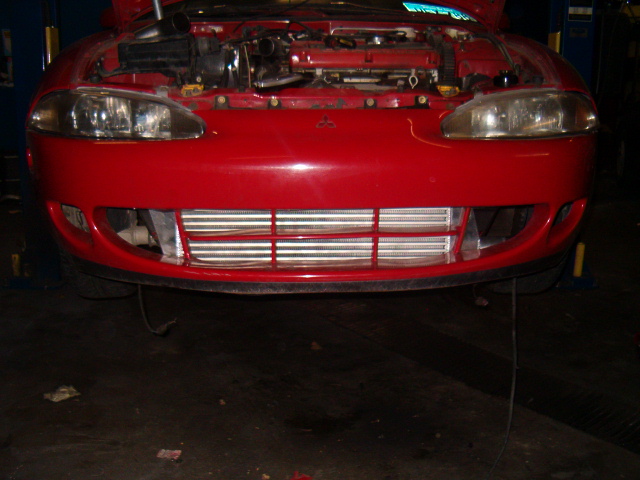

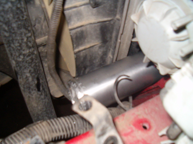

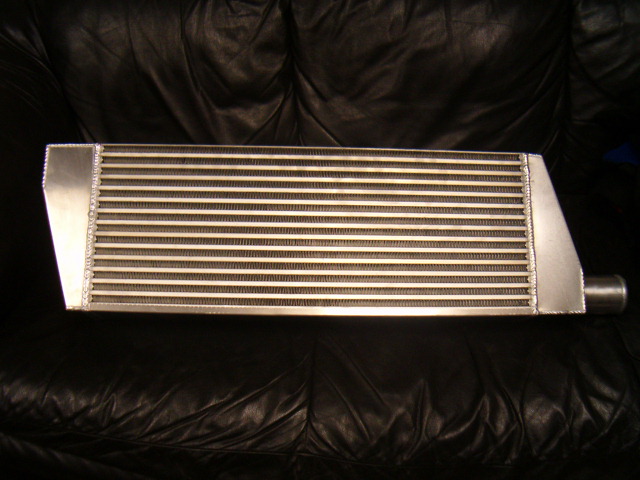

    Just finshed the core up and got it mounted today. Ran out of throttle body elbow flanges so i couldn't do the piping today so that'll be shortly. But we're using a 26x10x3.62 bar and plate core w/ backdoor outlet to the throttle body for shorter piping. The wider shorter core works alot better then most these 24x12 especially on the 95-96 where they have a short wide opening so this core has a lot more exposed surface area rather than all being tucked behind the bumper cover. Problem is w/ most kits on the 95-96 you have to cut the grill out which makes the bumper sag and look all retareded. We sucked this core back as far as possible to the radiator support so only minor bumper cover trimming is need on the 95-96, no cutting out the whole grill.
