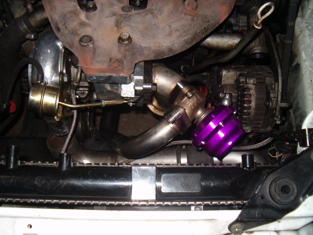

    Finished today. 2.5" stainless steel 02 housing setup for TIAL 38mm w/ external dump.

        Looks tasty. How much are they going to retail for?
          Starting @ $275.

            wtf 2.5 inch? when is the 3 inch coming
              3" wont fit nicely and clear the oil filter housing well. 3" also wont bolt up to aftermarket downpipes. This is designed to be a stock replacement and upgrade that will bolt to your exisiting downpipe.

                  you fab like a mother f#@&*r. looks nice
                    This is just a start. Doing a production run for 2 vendors next week so i'll have all sorts of stuff to post up.
