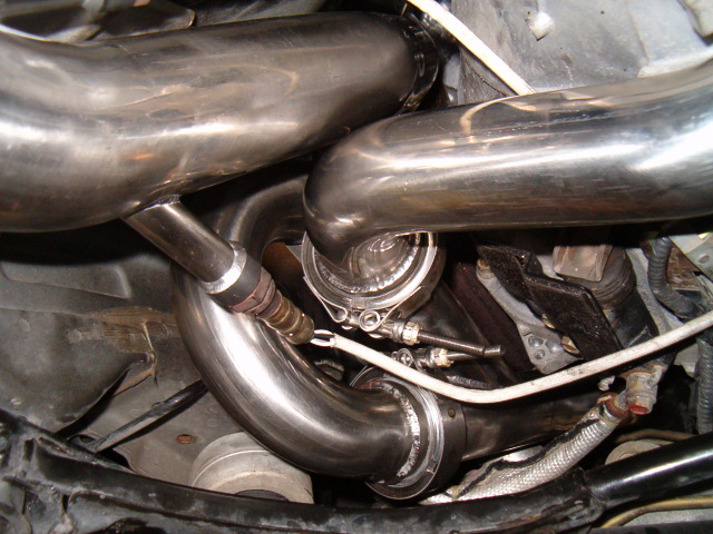

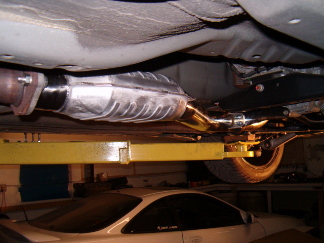

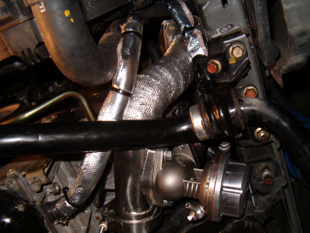

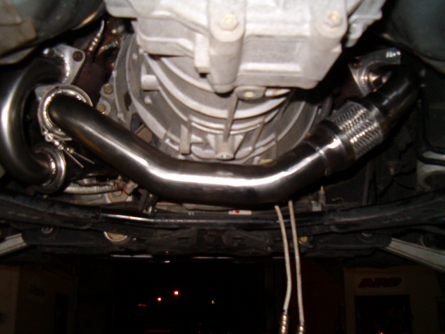

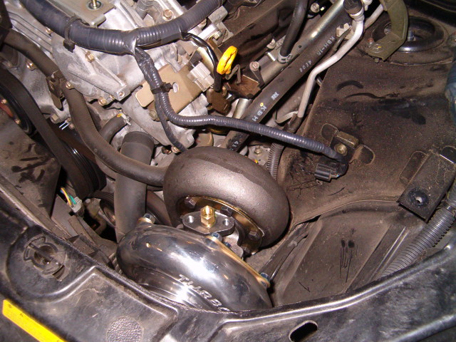

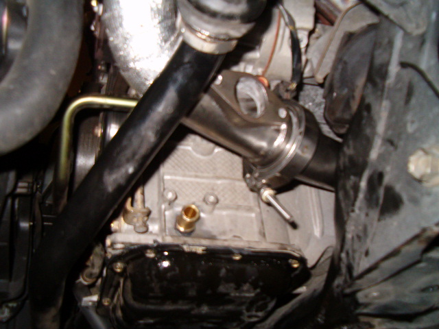

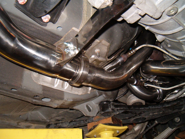

    03 G35 coupe, 6 spd.Turbonetics turbo kit, custom sheetmetal intake manifold, and Greddy E-manage.

      that cars f'n tight
        is that on the "skyline"? how much HP should that make
          350whp? who knows if that sheet metal intake will make a difference at that low boost level...i dont really know anythin about the stock intake setup on those cars so who knows....
            aliengotpsi
            its a skyline so 600-900 hp

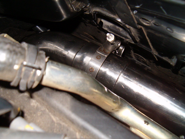

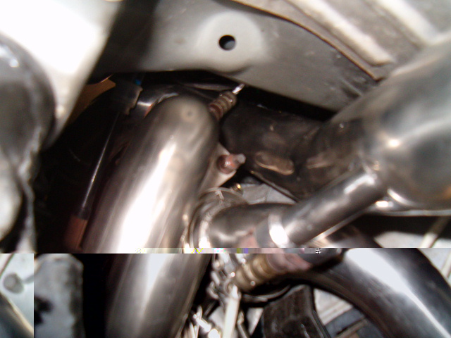

              Why are you running e-manage with a VQ motor. They have had nothing but problems with them. To think that Utec and AEM figured it out and you went with something that is so unreliable. That is just my warning from one VQ owner to another. Good luck.

                I am pretty sure it was the customer that picked out the parts, I believe SLS is just putting them on.

                  Yes, he wants to run the E-manage. Im not to concerned w/ it, we are running the full unit not just the basic. So we got the ign harness, timing harness, knock sensor adaptor, MAP, rpm signal adaptor plus all the fuel control. The turbo kit also does come w/ an ECU reflash we can use then fine tune off that if need be.
