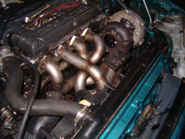

              so where do you put the wastegate on that type of equal length setup?
                About 95% finished. Just gotta add wastegate flange and some finishing welding.

                  Kevins motor?
                    doing a good job Nick.

                            all I have to say is, if this is the first time for you building manifolds then you learn quick. I've seen brand name manifolds look just as good as that. 🙂
                              It's gonna sit behoind the turbo either above runner 3, or runner 2, i haven't decided yet. I wanna drop it in a 1G and see if it'll clear and see where the easiest spot to get @ a wastegate would be. But there's definatlymore than enough room for it.

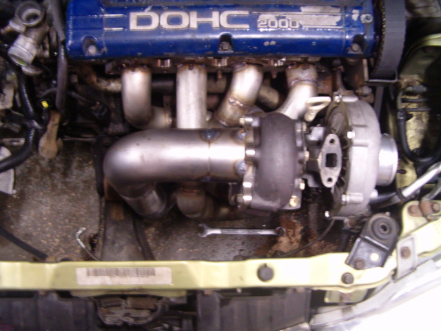

                                      I just tore one down. To fit a 1G it will for sure need a 3" collector rather than the 5" i used, which is no problem @ all. But to do a setup like this you're either gonna need to be running setup w/o a MAS or some rewiring to relocate the MAS. I can build a more simple style to suit cars that a more stock based if need be, thats not a problem.
                                      Maybe over the weekend i'll play around w/ another design for something a little simpler. Nice thing about this one is its so easy to bolt up the head, you can access all the bolts w/ ease :-).
                                        Either way for this one it done matter cuz it's gonna end up on Kevin's car anwyays. Being RWD there's not exactly anything over there to run into for fitment issues esp w/ the new front frame the strut towers and everything will be gone.
                                        Blake are you even gonna keep that 1G?
                                          Few in car pics.
