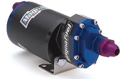

      How loud are the Weldon pumps? is the pump like you have good for continuous use or no?
      I picked up a Magnafuel 4301
      Any of you heard good or bad about these pumps?
      FWIW
      I have been using that exact pump for the last 2 years. It is a great pump, I had one issue with it overheating, but after sending it in and them fixing for free its been flawless. It was 95 when it overheated, i havent heard of such problems with other users though. There was older style wear plates in there that expanded and locked it up when overly hot.
      I have a 74micron pre filter and a 40micron post filter. I have part #'s if you want and it will save you money buying direct rather than through a vendor.
      -8feed and -6 return (Stainless all the way)
      Line runs in one rail across the front through the other, out the back,and into the magnafuel fuel pressure regulator.
      Depending on your power goals you may want to increase line sizes.

        thanks for the info! glad to hear you have had good luck with it.
        I already picked up my plumbing supplies sadly 😞 ... got a magnafuel 74 micron and 10 micron filters... and the big magnafuel 9950 regulator with -8 return
        some of you may think i am retarded but i plan to run my regulator in the back of the car....going to run a high static fuel pressure and un-referenced.
        I like the simplicity in the engine bay with no fuel plumbing there... i will see how it works like that, i can always change to referenced
        will be -10 to the pump... -8 to the FPR.... -8 from FPR up to the front rail... and a -8 return from the FPR right to the tank
        -8 will support 1k hp.... I am not crazy like some of you guys so it will suffice 😉

          What fuel pressure are you going to run? How are you going to feed the rails?
          7.64 @ 187 3400 lbs. on KORN
          TTSBF
          RTCTTFMF PTOSITW
            IIRC most gm stuff is all now 58 psi
            I will probably start at around 65-70psi (the injectors i got are supposed to be great and happy at high pressures)
            if i run into heating the fuel too much i will stick a cooler in the return line because there is alot of room back there
            vette guys make as much power as i want on stock fuel lines with the stock unreferenced FPR in the back so i dont think i will have any problems at boost levels less than 15psi
            all i will have going forward is one -8 right up to the rail...
            rail will be modded like this with the addition of a -8 feed...(with stock feed cut off flush and plugged, though still acting as a cross over)
            So am i really retarded or just sorta?? haha
