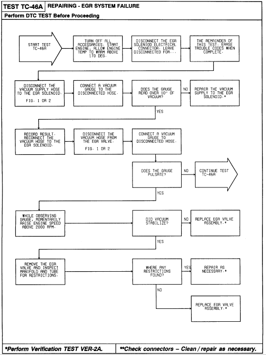

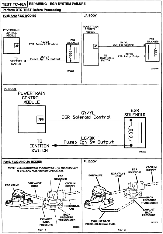

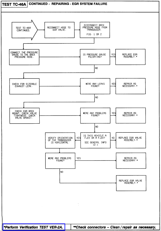

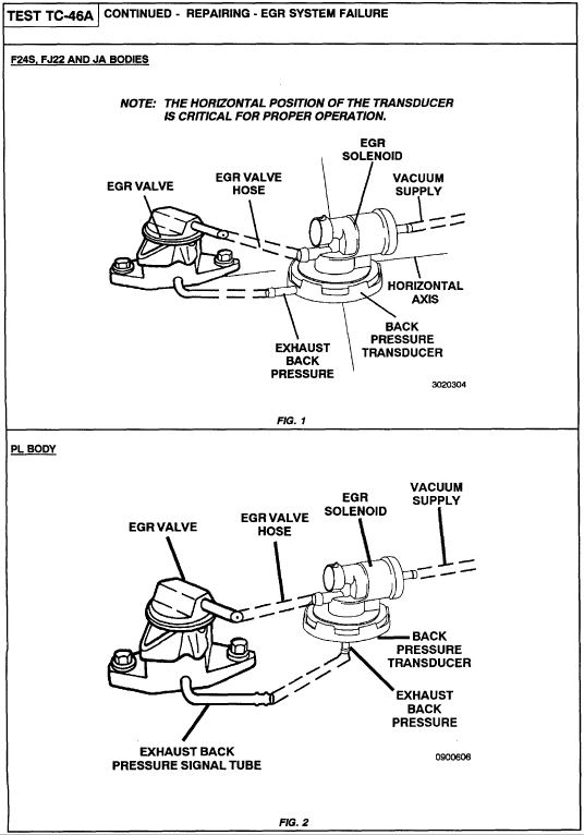

              heres the diagnostic flow chart, get busy.

                  only way to know 100% whats wrong with it 🙂
