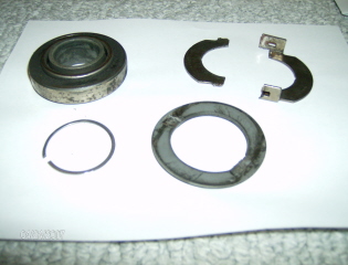

                i got my tranny out and i noticed a few pieces of metal just hanging out by my clutch. this is a pic of my old throw out bering- the one that come with the act clutch kit. notice the back plate is broke in half and the bering was barely attached to the fork. i'm putting a mitsu throw out bering in. thanks for the advise
