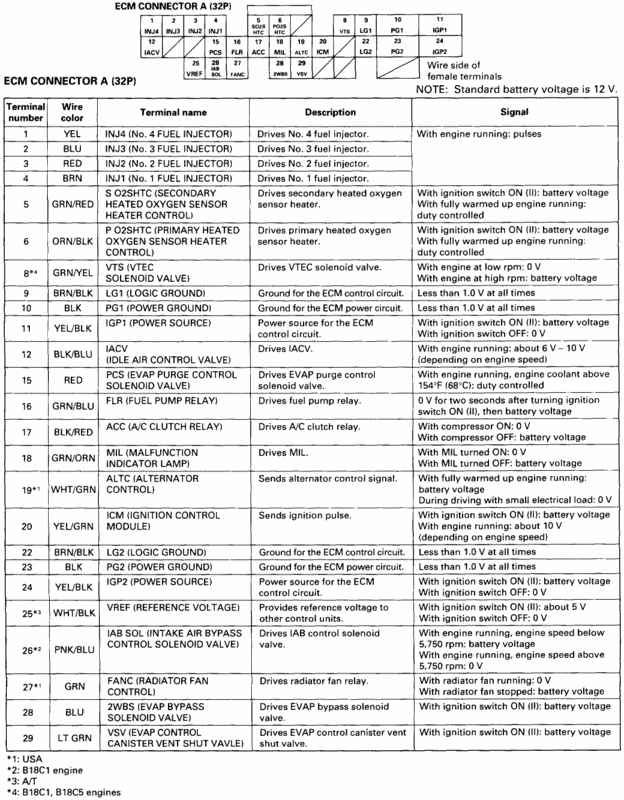

    i kinda know how install it but i need to know wher the rpm wire is on the ecu in a gsr any body know be nice if i can get some help

                Blue with a white strip in a connector all by itself inside the engine bay on the drivers side.
                  its right by the engine wire and the radio wire.

                    thanks alot guys i m goin to try to find it
                      s13teg
                      well i will just keep looking i found a blue and silver wire that is conectet to a littel harness by it self thanks
