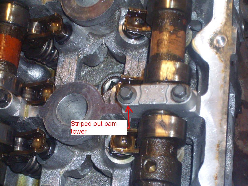

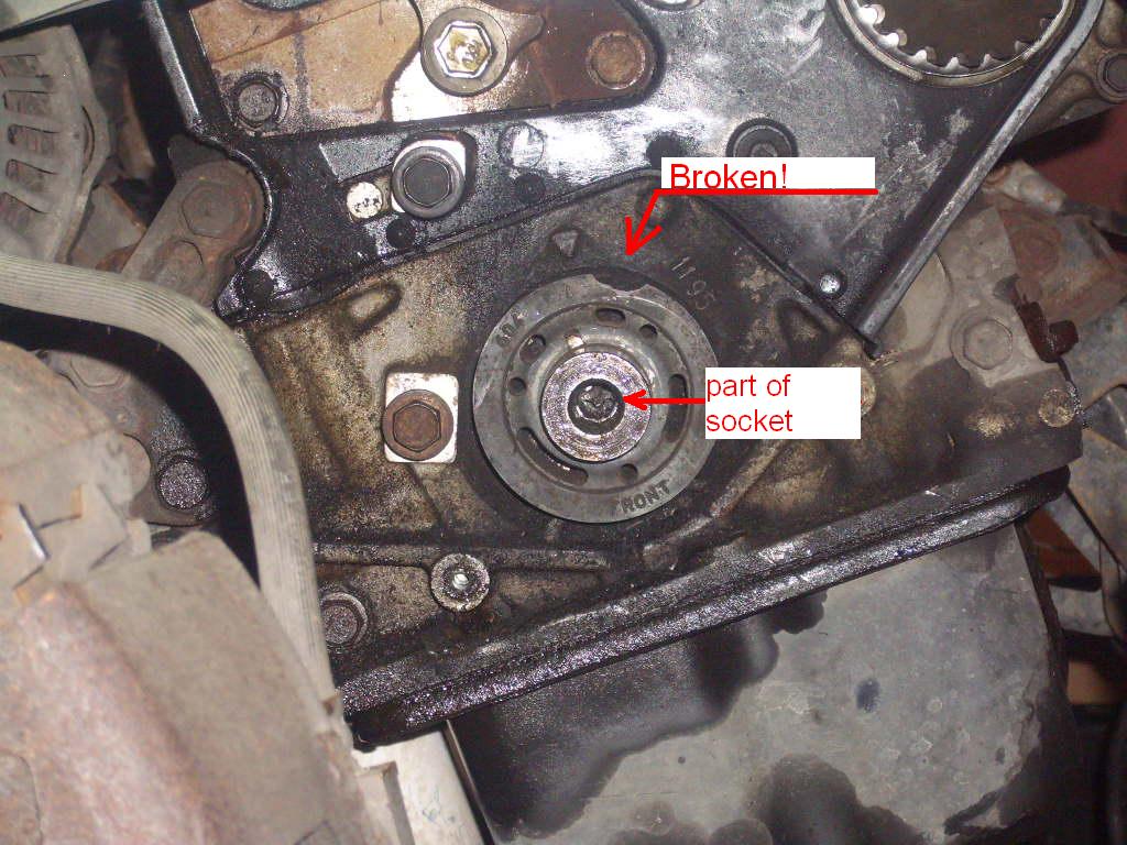

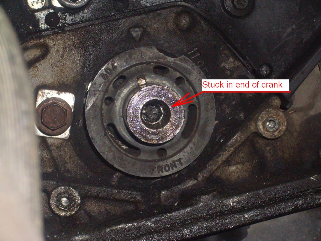

    ok I have a neon with the 2.0 dohc and one of the cam tower bolts got stiped out during some point of rebuilding it and I was pulling off the harmonic balancer and busted a 1/4" drive socket in the end!!! I have a pretty good idea on geting the socket out... thinking of thinwalling it and a little chizling and i shud be good! anyideas on what to do.. other than flamin on the neon any help would be great. thanx

      Helicoil... Done. BTW thats a cam cap bolt...

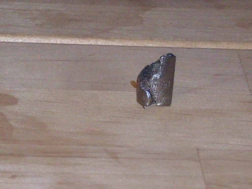

        yeah fixed that today with a helicoil kit and drilled out the socket in the crankshaft... shoulda just bought the right chrysler puller....:mad:
