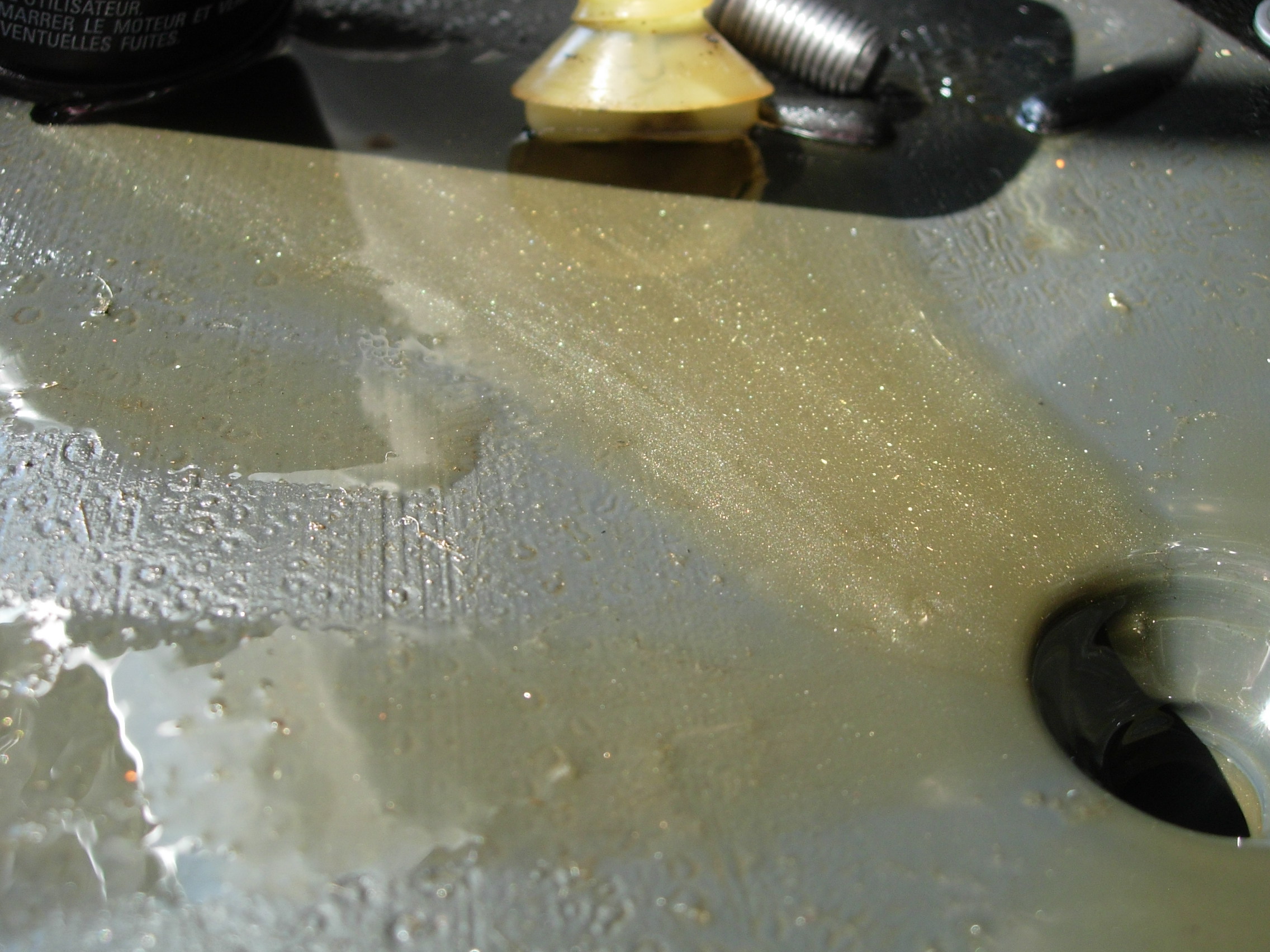

    So I had already racked up 60 miles on this new bike that I just got on Monday. Figured I would be smart to get that oil out of there and some clean stuff back in. Anyone who has broken in a motor before has seen this before... if they were paying attention. I just figured I would share some imagery for those that are interested in seeing what lots of metal flake in oil looks like 🙂
    This is the backflow from the old oil filter. Some flake came out of the crankcase but nothing like the junk the filter puked up.
    I didn't reduce the pic so the detail could be seen.
    The video looks pretty cool too.

          This right here is why people shouldn't wait 500 miles to do their first oil change. You should really do about 4 or 5 in the first 1000 miles.

            My motor in my DD 240 has like 400 miles on it. I have changed the oil 3 times. Once before it left the shop, another at 25 miles, and then at around 150.
