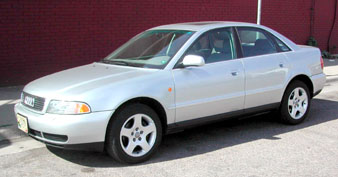

    hey i drive a 98 audi a4, i want to add some performance, but there isnt that much available that would give me the hp numbers im lookin for, i would really like to swap the s4 motor into it but i dont have any idea where to start on that, im not sure of anyone who deals with the audi's. any idea's?

                  well im looking to add as much power as i can with out taking away its driveability, im willing to spend a fair amount of money.

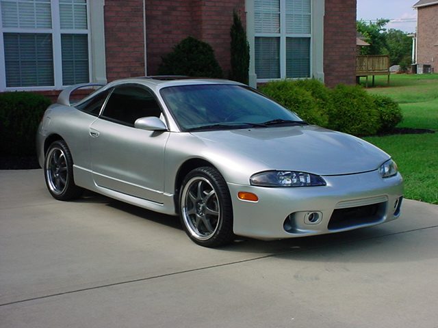

                      matt what do you need any mods for...cant you already beat rays evo..or even my eclipse?

                            first of all i have never said anything about beating an evo, and secondly your eclipse is a peice of shit, the last owner disconected the odometer....hmmm maybe thats why your motor blew to shit. I saw that eclipse lose to a mustang that runs 17's
