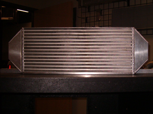

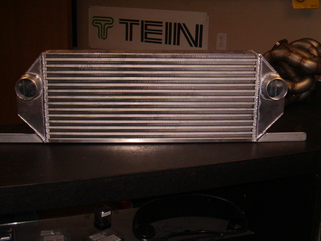

    New design we did up utilizing a double back door for Honda/Acura. Mocked up on a 98 integra. Will clear w/ a Single wide radiator w/ minor trimming on the radiator support similiar to whats done on the 1G DSM kits. Eliminates a good 2 ft off each side of the IC piping.
    25"X9"X3.5" bar and plate core, 2.5" inlet/outlet.

      did you do all the welding and fabbing on that?
        lol i was going to ask the same thing do u do all the welding on the tank and stuff and just get the core
          Little bit of both. Depends on the application. I've gotten a few bare cores and just done tanks and then other we get the tanks already on them. All the 1G DSM stuff we get pre-done as they have nice 1 piece cast alum tanks. Never gonna have to worry about those blowing apart.

              I just finished the piping for this FMIC and top mount turbo setup. Overall piping length was reduced by 5 feet compared to my old setup w/ a side to side intercooler.
                Cuz my backdoor setup is the shit!!
                To bad your still gonna have lag like hell.
                  Yah. Price you gotta pay to try and go fast with a little tiny motor I guess.
