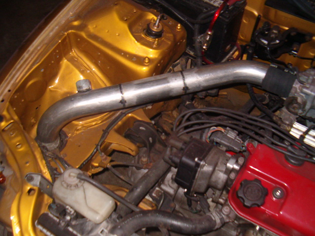

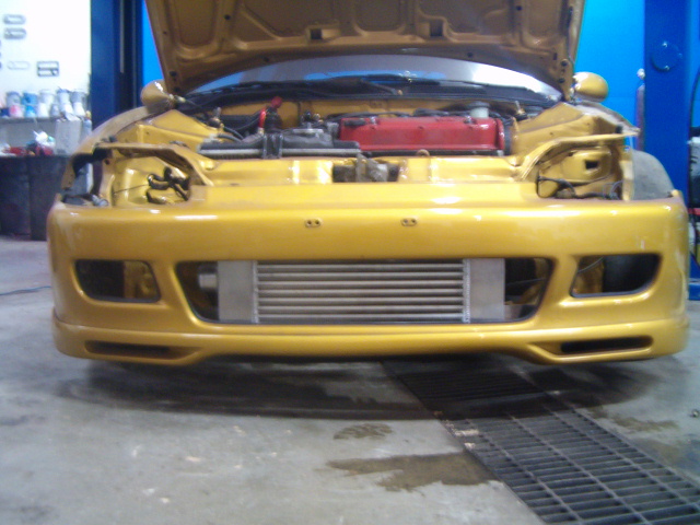

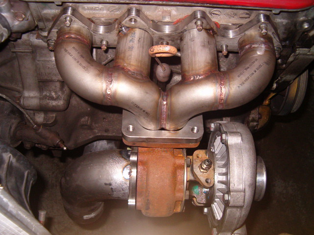

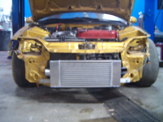

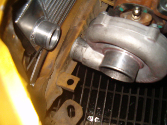

    Just finish some mock up for this today and got the IC finished/mounted up.

      damn looks good...really short LICP i see

          Looks good, thats a healthy sized intercooler. 🙂 And looks like you'll need a huge length of piping between the turbo and intercooler. 😛

                IC isn't actually all that big, but plenty large to support this setup and actually fits in the front end pretty nicely. Its a 18x9x3.
                  That is a super sweet set-up there almost makes me wish I had the old EX.

                    how big is your lower intercooler pipe going to be??

                      2.5" diameter. Im gonna redo the inlet on the IC and extend it probably 2" more so there's no pipe just a coupler.

                        By the looks of the pics, all you would need is a 6" or so coupler. Are you thinking diameter or length? Or I guess if he really wanted to he could use some 2.5" pipe and bend it all around and make it like a big jungle gym and about 8 feet long 😉

                            nice setup man. real nice on the header
