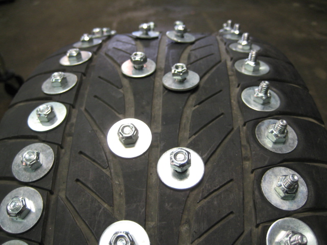

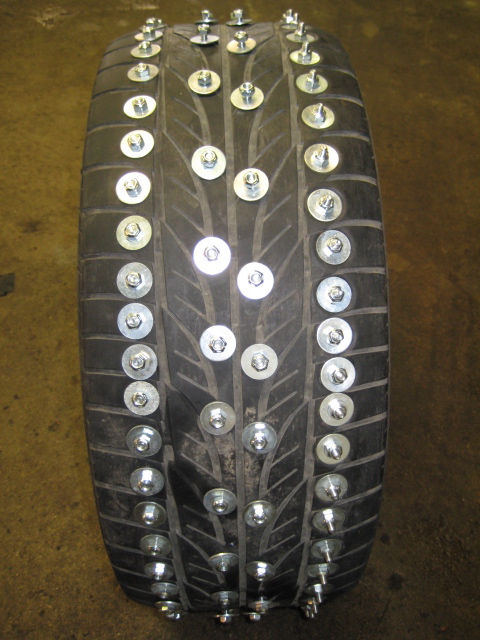

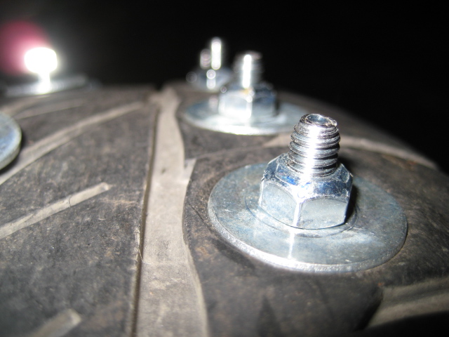

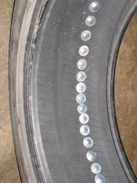

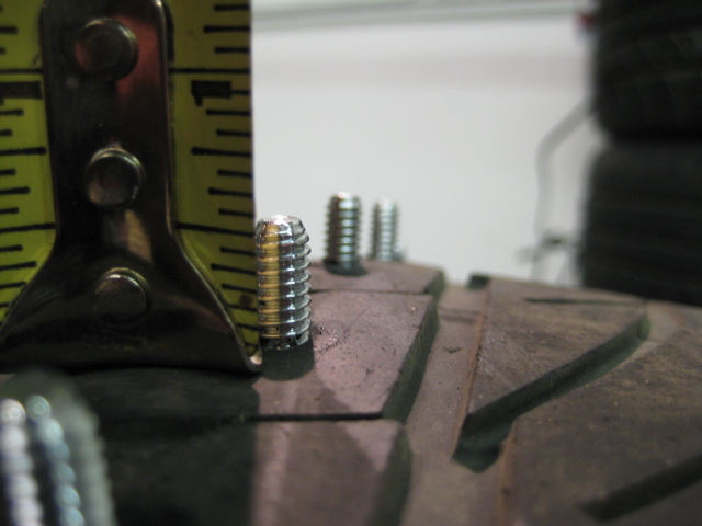

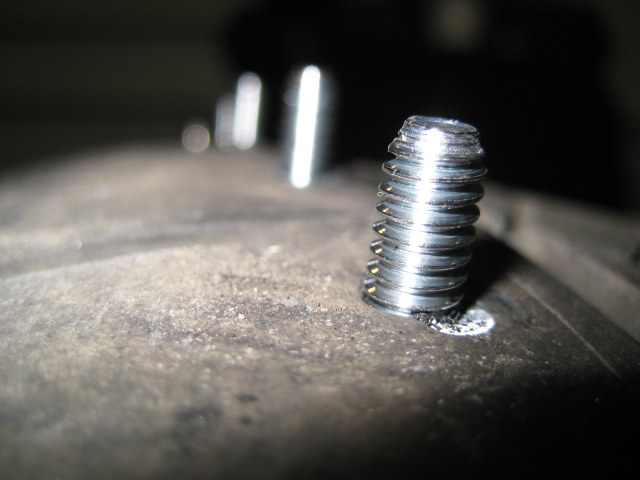

                                          aliengotpsi
                                          #50
                                          Few pics of my ice tire..
                                          These will be going on my 500+hp EVO
                                          245 45 17
                                          180 Bolts/tire
                                          180 Locking Nuts/tire
                                          360 Washer/tire
                                          I will sharpen the bolts if needed.
                                          Kevin Smith
                                          Straightlinedetailing.com
