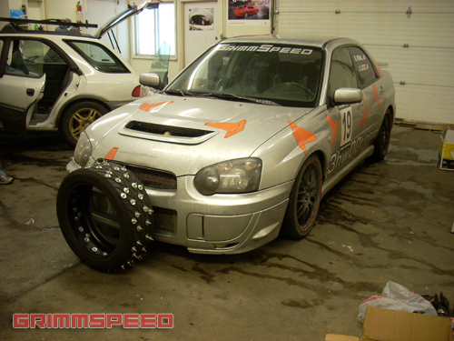

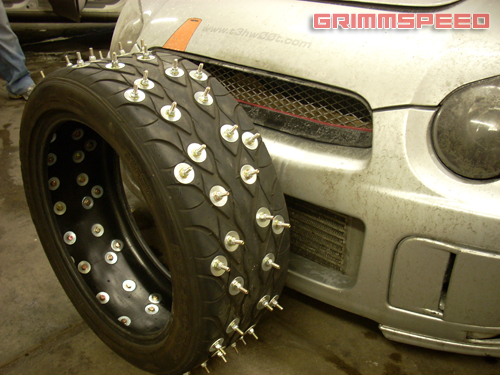

                                      Ive started this on an older set of tires...
                                      I used 1'' long 1/4'' bolts I plan to use a inner tube inside the tire so it wont leak.. I will then cut down the bolt to 1/8- 1/4'' above the locking nut.
                                      im sure its a 4 hour per tire process..
                                      I also have some hankook iPikes if they dont turn out..
                                      Come on guys tell me 2 good reason's why you wouldnt want to do this?

                                          Kevin:
                                          You should have just bought this...
                                          http://www.moto-man.com/Kold-Kutters-Ice-Screws-40250ct41_p_1003.html
