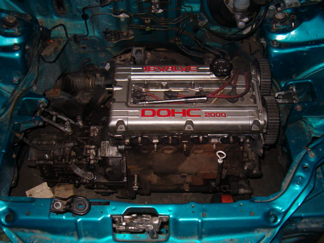

      Quit whoring the thread anyways, this is about Nick putting a 4g63 into his hatch. What are you plans with the axles? Just get some DSM axles cut and resplined? That is pretty much the only difficult thing to do. Do you know of a place that can do it?
      [email protected] -- DSM
      07 Mega Cab 5.9 CTD
      • P
        P
        DSM inner hubs in the trans, honda outter hubs into the spindles and then have the ouuter sides splined to accept the Honda hubs.

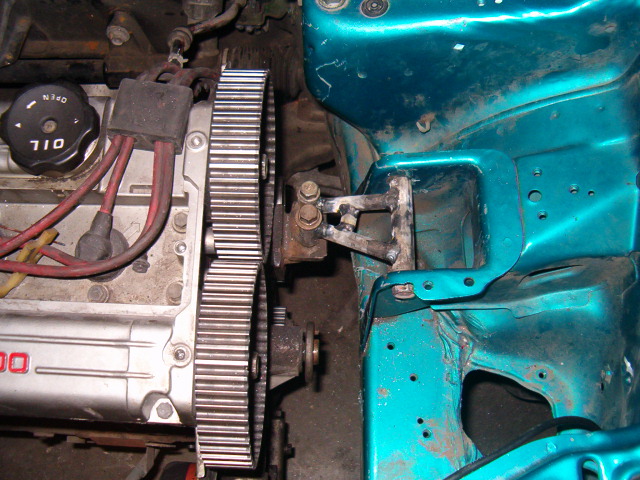

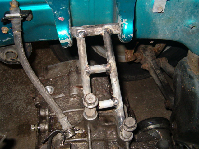

                      Got the 2 solid side mounts done tonight. Motor is officially mounted in the chassis.
