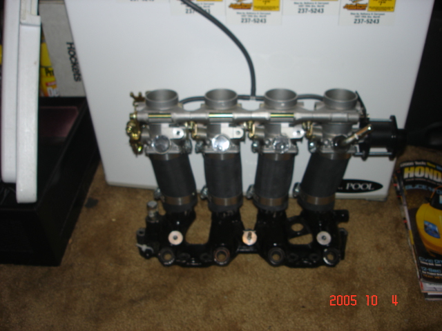

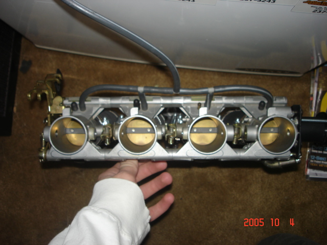

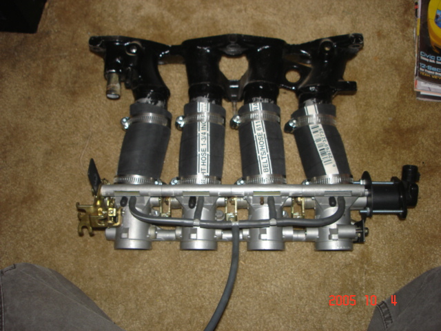

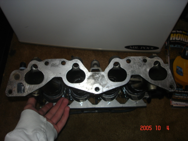

    Here are my new toys. they wont be going on until i get a good enginemanagement system tho. I think i am also going to have the plenums redone so they are straight since the ports for the ITB's match the ports on the stock intake mani. Here are the pics.
    Oh and they are GSXR Throttle bodies attached to a cut stock IM.

      You just jumped in way over your head as far as whats going to be all in making these work. What exactly are you trying to gain here especially w/ a stock motor SOHC?
        groshogn obviously didnt want em, so u better make good use of em. also, u need some velocity stacks. and get rid of the hose clamps/couplers....i smell vacuum leaks

          I did my homework and i also have a Honda-tuning article where they made these exactly how these ones are and all they did was bolt them on and tune it with a VAFC and got a gain of 21.3 WHP. I have been researching these since i saw the article and have many threads saved about them. Its fairly simple besides tuning. I am not installing these until i get an EMS. I am hopefully going to save up for AEM and if not, hondata. I cant just use chrome or uberdata due to lower rpm tuning problems(sub 5500). Here are a few sites:

                                        what brand are they? i'm guessing not toda.
                                          pin
                                          They're from a Suzuki GSX-R motorcycle. http://www.homemadeturbo.com/tech_projects/itb/
