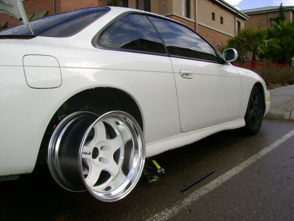

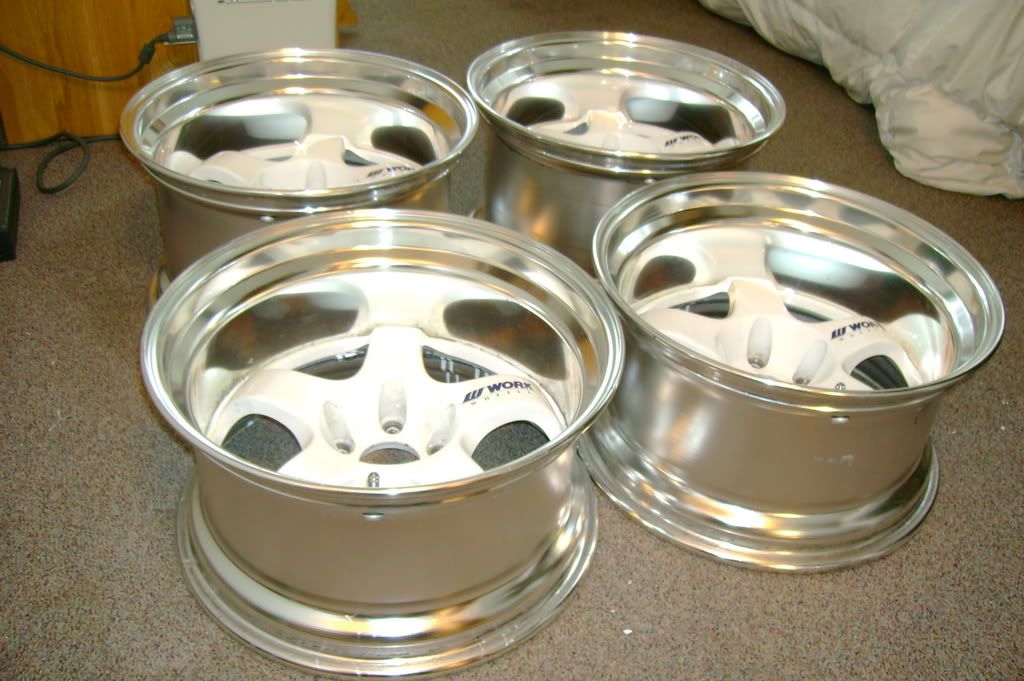

    work meisters s1 17x9 -69 17x10 -52 (those are suppost to be negative offsets)
    anyone know what these would even fit on/discuss.

          those would look damn perdy on my conquest as I can fit up to 11" wide wheels in the rear and 9's up front, I don't like the white though.

                Ya, but you need to think about the offsets. For the fronts, if they were on a s14 you would need 80mm widebody, and not to mention you would not be able to turn. The rears would require at least a 60mm widebody, unless you run hardcore strected tires, and mad jdm camber.
                    there was a guy on 240sxforums that ran i believe 10s all around on his s14... ill try and find the pics but if memory serves me right it had quite a big lip on the rims
                    > Parker;299126 wrote:
                      Ya, so. Rim width is not the only thing that affects fitment. Its the offset. you could but a 17x9 +50 on a 240, but then put a 17x9 -50, and it will stick out 100mm further then the other 17x9.
