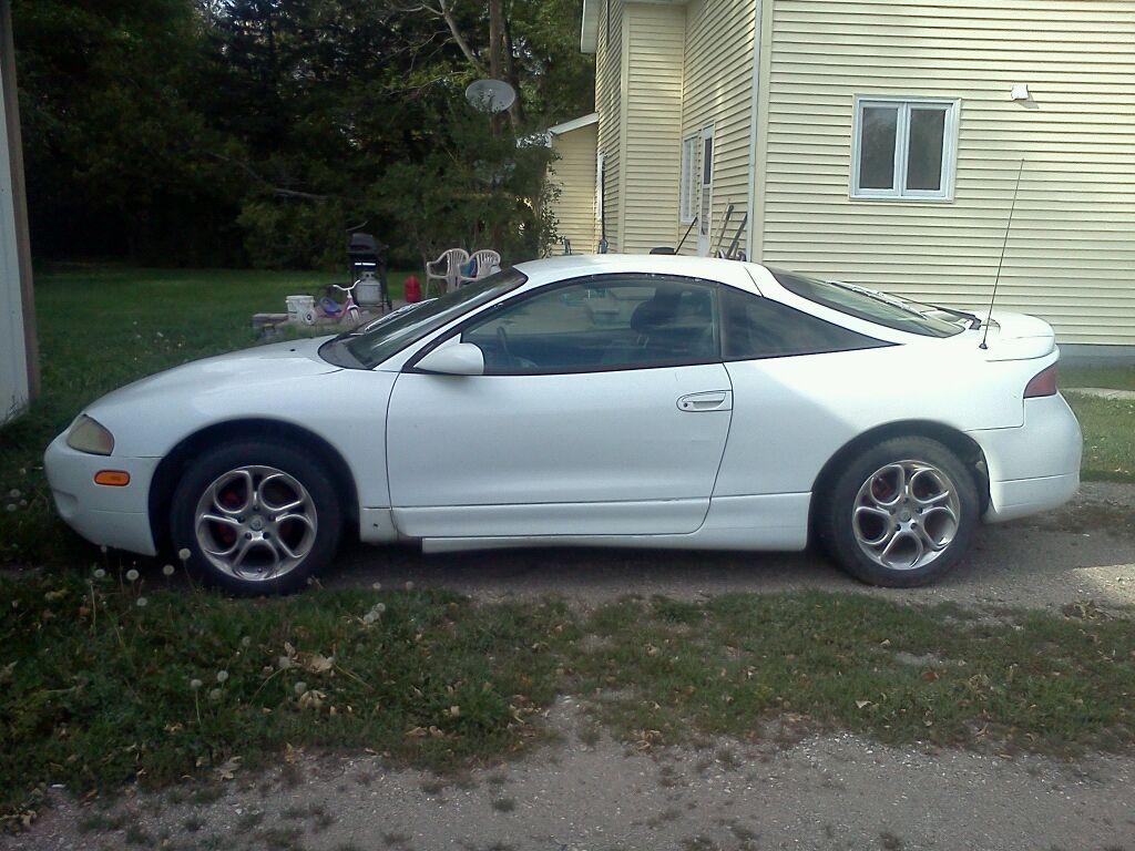

  • 95 Eclipse GS
    0 05GS
    Photo Albums Archive
    ![iPhone 039.jpg](/assets/uploads/legacy/attachments/6859/iPhone 039.jpg)
