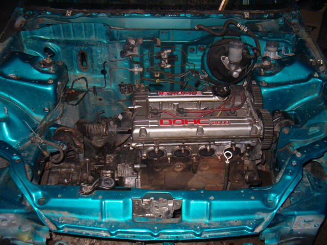

    Began retrofitting the 4G63 intoa 92 civic hatch last night. Got both side mounts fittedand motor sitting in the chassis. Need to do some slight adjusting to the trans mount to shift the motor back a bit other than that fits in there pretty nicely.

      Is it gonna be a front wheel drive, or AWD?
          Start off as fwd for now then work into awd.

            Awesome. Is that your car Nick?
              Yup.
                damn thats gunna be pimp. is this a new hatch you picked up?
                  Yeah, just got it a few days ago.

                    Nice How Much Boost U Putting On It?

                      that is pretty wicked. planning to post a blog on ht and dsmtuners?
                      is it a stock 4g63?
                        Stock 4G63. No need to build these motors. I ran a stock rod, stock head, stock 2G piston motor in my 93 that laid down 530whp. I'll run race gas on 30 psi on this. Goal is very cheap 400whp sub 2000lb car. Might even run a NA bottom end for the compression.
                        Gonna try push this project along quickly and have it ready w/in a month or so. Only downtime will be getting the axles splined for Honda hubs. Otherwise everything should be a breeze once all the mounts are built.

                          i guess its time to put a v8 in my dsm then huh nick?

                            Why would i wanna do something that stupid???

                              sorry, should have been more specific about what i meant by "stock."
                              i was implying stock block, head, trans, turbo, smic, etc... i should have known better...
                                that is freakin awesome...

                                    It'd be the dumbest thing i've seen yet. Trading a 4G63 for a V8, hmm, no thanx!
                                    And no this isn't gonna run a stock turbo and FMIC. Custom manifold, FMIC, piping, etc..
                                      mwc youd be gettin rid of one of best motors made...that thing is indestructable

                                          Nick I can't pull my jaw off the floor. Got any pictures of the hatch? How much did you get it for?
