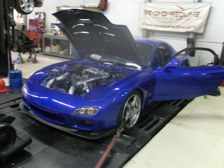

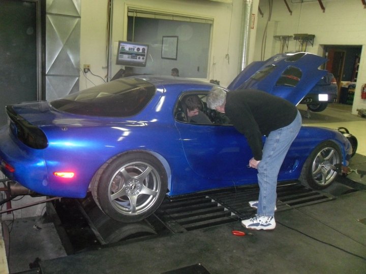

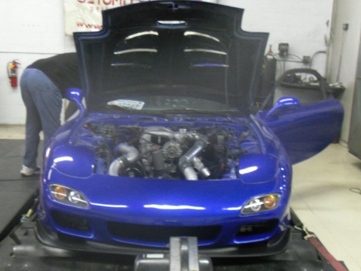

    Here are a few pics of the car on the dyno down in Green Bay, WI. Took it to a place called beyond redline. We had a few issues early on, but the owner/tuner down there is an absolute genius! we got it up to 466/370 rwhp/ftlbs tq before I was getting ignition break up. The motor is running extremely strong as was happier than a kid in a candy store even at 20 psi. I was only getting knock readings of 20. I could have gone a lot higher if i didnt have the ignition break up but overall I am extremely happy. The old guy in the picture is the engine builder, Howard Coleman. He did some suspension work for Mario Andretti and also race with Paul Newman in the GT series. He used to race RX-3's and set alot of track records.

      those numbers are SAE too, not standard.
