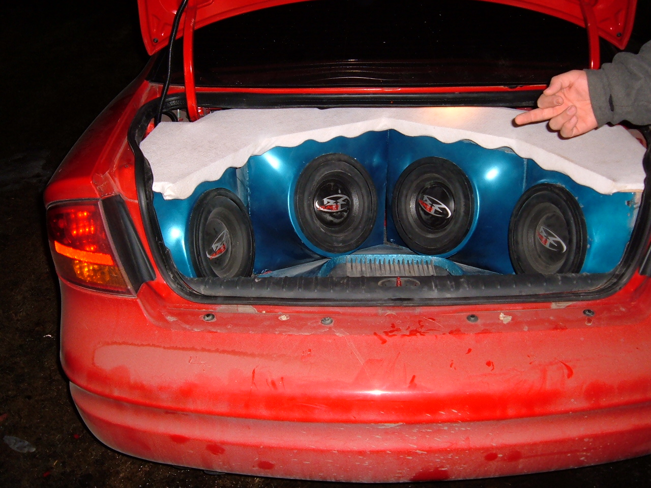

    no they are not built to spec but they are in the spec range. it is loud as hell though
      i think it wouldve been cooler if it was one big box instead of 4 seperate boxes. maybe a different color too. still not bad though.

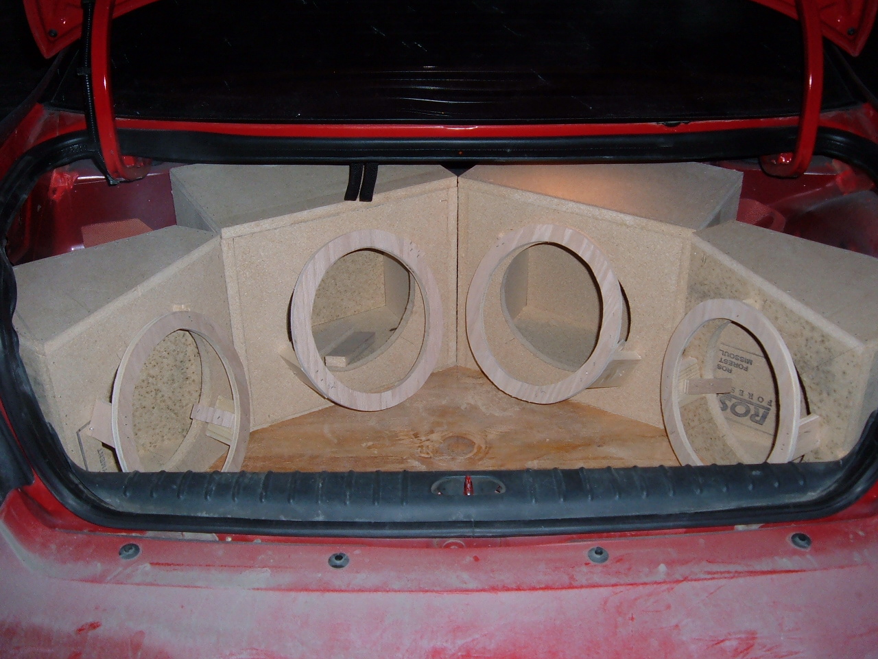

        yeah that would have been better but we wanted it to be able to come out of the vehicle easily without destroying the boxes, they will be screwed togeather and raised up a little bit so it will almost look as if there were only one box.
          if you are going for any sort of competition grade sound system it will REALLY be to your advantage to use one box size for all of the subs. Even a .1 cubic foot variation can change the QTC of a subwoofer system tremendously and while they may still be loud, there may be gaps in the response curve from the subwoofers not moving/behaving linear.

            thats why i asked about em i guess...i just didnt really say that
