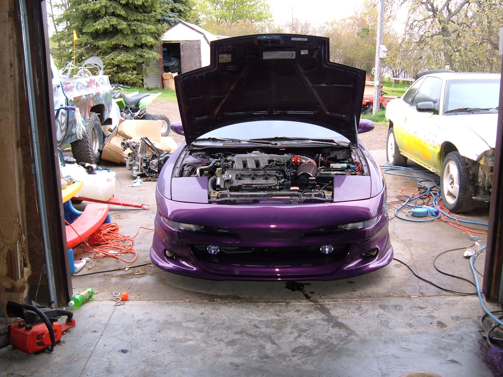

                                      here is a couple updated pics of the probe, one is of the front bumper refiberglassed and repainted and the other is of the mazda motor in the probe I also got a new ECM with the KLZE Chip in it and the rev limiter raised to 8000 RPM runs decent but still a few problems to fix. but i guess that comes with any engine swap.

                                        just to add, the pic of the front of the car the oil under the car is not from this car it is from the engine in the background on the left, that is a totally different motor swap in progress in a mitsubishi mirage. yeah because i was taking the probe off of blocks last night and backed into that motor so i got mad and picked the motor up and threw it outside and that was just some oil that came out of it.
