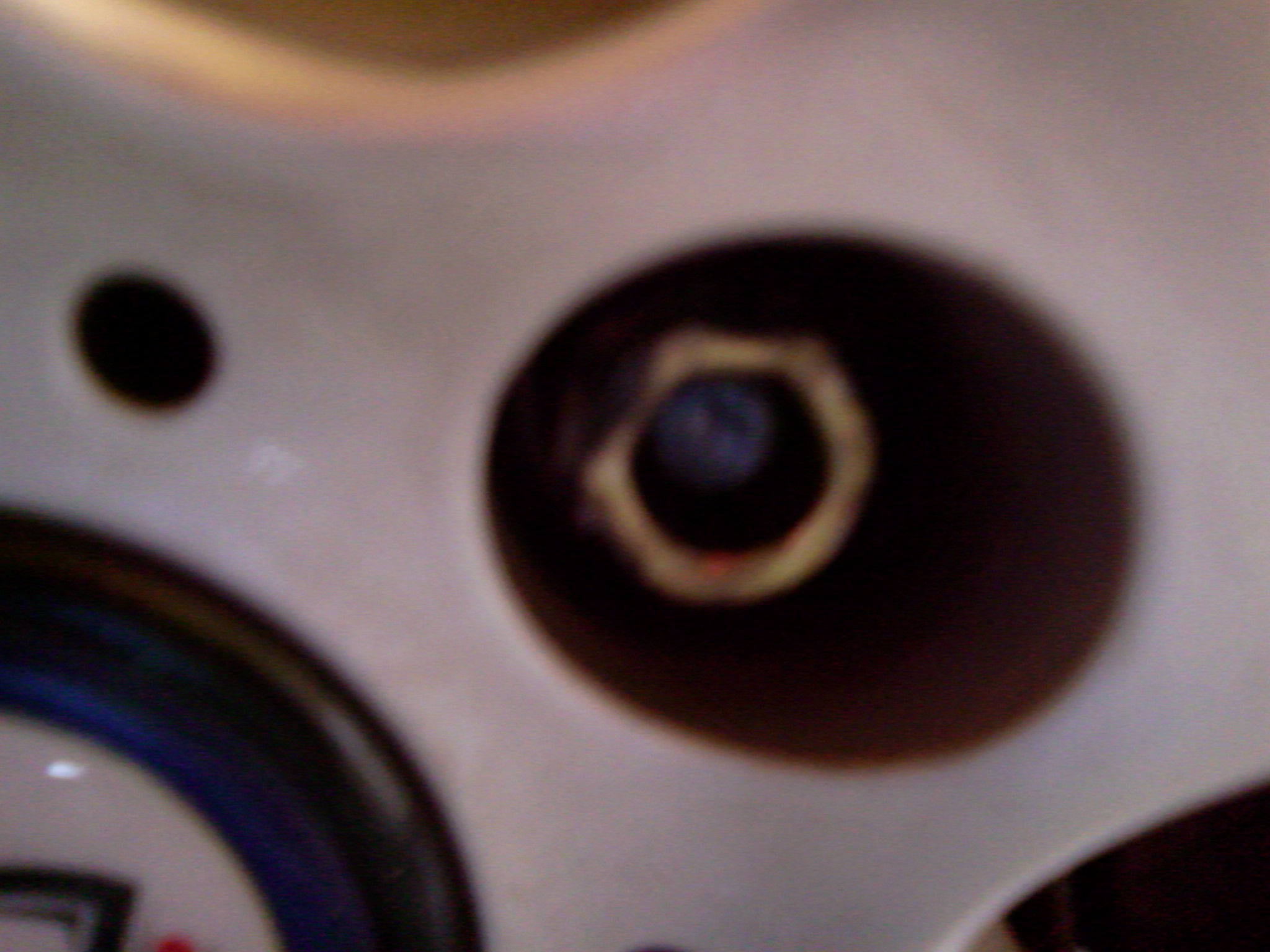

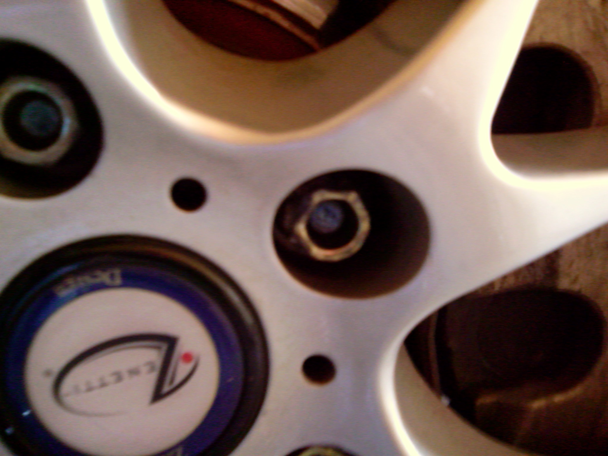

            Here a a couple of shots of the nut in question. It basically has four regular sides and a part circle.

                Ohhh one of those 😞 id try some sockets that are a lil bigger and [COLOR="darkred"]carefully [/COLOR]try to loosen it, if all else fails dremel the proper socket to match.

                    take a 12 pt socket that is almost the same size and hammer the SOB on the lug nut. You may find someone with the same key, but not real likely. Ruin the 4 "security" lugs and replace with regular ones and never have the problem again.
