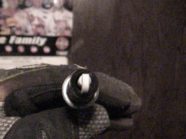

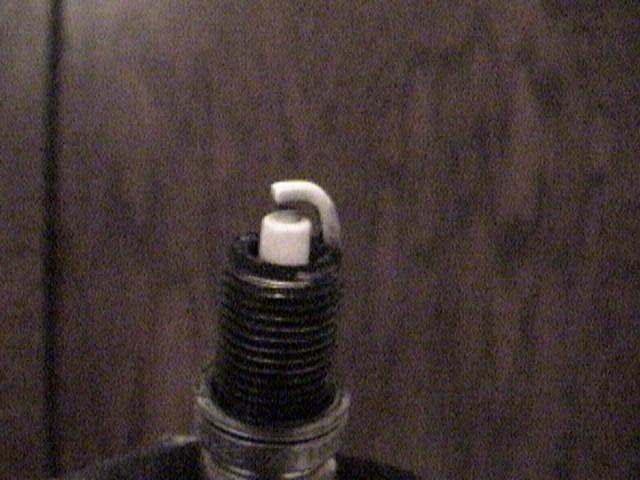

    :eek: My civic is running very lean. I know this because i "read the spark plugs". Here are some pics. The pics are kinda crappy quallity. 😞

      how in god's name is your stock civic running that lean... what have you done to it? where is the timing set at?
      even if it was fully advanced you shouldn't be able to do that.
      • dubbsyD Offline
        dubbsyD Offline
        dubbsy
        holy crap. what is that, about .020 gap on there?
        and yeah, think it needs just a bit more fuel....

                      Looks to me like spark plugs out of a relatively stock car.
                      My integra always had plugs that looked like that when it was stock.
                      As long as they're not speckled, you're fine.
                        tqisking
                        I agree with integra....plugs look fine but maybe 1 heat range to hot....if there are no black specs then let it run....

                            I second the heat range idea. I would rather spend six bucks on new plugs then sixty taking it to the dealer only to find nothing is wrong.
