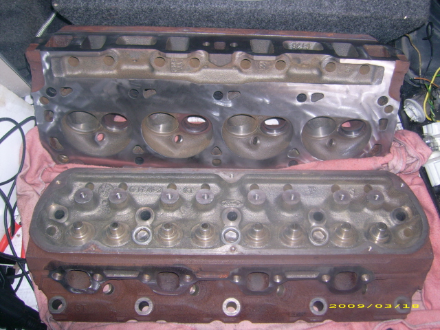

    Picked these up from the cities last weekend for a steal! 🙂 They are the GT40heads that came on the 93 cobra mustang and some explorers. Just got them back from the machine shop today and got the green light to start building them.
    As soon as i get my package from Summit i will be doing electric fans and an A/C delete. So muck work to do! Should be enough to get the pony going a little quicker. :icon_salut:

        Good deal. What cam do you have in there?
          I have The E-303 cam.
          Duration 282/282, Lift .498/.498
            Looks good man, hopefully a new personal best this year!

                I think I have a F cam if you want to swap. I'll have to double check specs, it could be a B-cam I just don't remember.
                E-Cam
                .000 282° 282° .498
                .050 220° 220° .498
                F-Cam
                .000 286 286 .512
                .050 226 226 .512
                7.64 @ 187 3400 lbs. on KORN

                        I have a 272 @ .050 with .714 lift you can try too...
