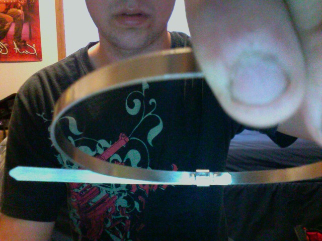

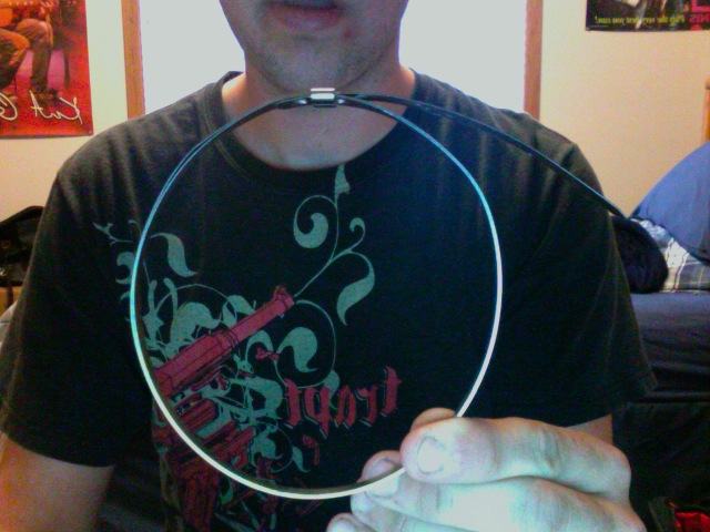

                    depends on the style clamp...there are two common ones...both have special tools to do it but both can be done without them....pics of clamp.

                      Here are the pics of the clamp. What tool is it?

                          those clamps are GARBAGE...if you want any of your grease to stay in that joint then go buy the other style clamp. if you need to use that one then I would suggest getting the tool to do it...you can do it without the tool but it will fail even sooner. 🙂

                              I'm not sure what the name of the clamp is but it is a "pinch style" clamp...there is a special tool to do it...but a pair of side cutters will work just fine with them as long as you don't actually cut the clamp in the process....

                                    Those are called Oetiker clamps. I think I paid something like $30 for the Oetiker/Knipex tool for them.
