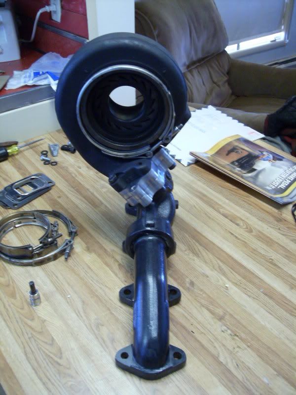

    well the hy35 just wasn't cutting anymore. decided to go with a holset he351ve. using Fleece Performances vgt controller to control the veins. also putting on a 4" downpipe, an ATS 3-piece manifold and magnaflow 30" muffler.
    veins closed
    veins open
    had to use and adaptor to make it fit on a t3 flange
    this is what you get when you leave zac and me alone with a bandsaw and a welder.

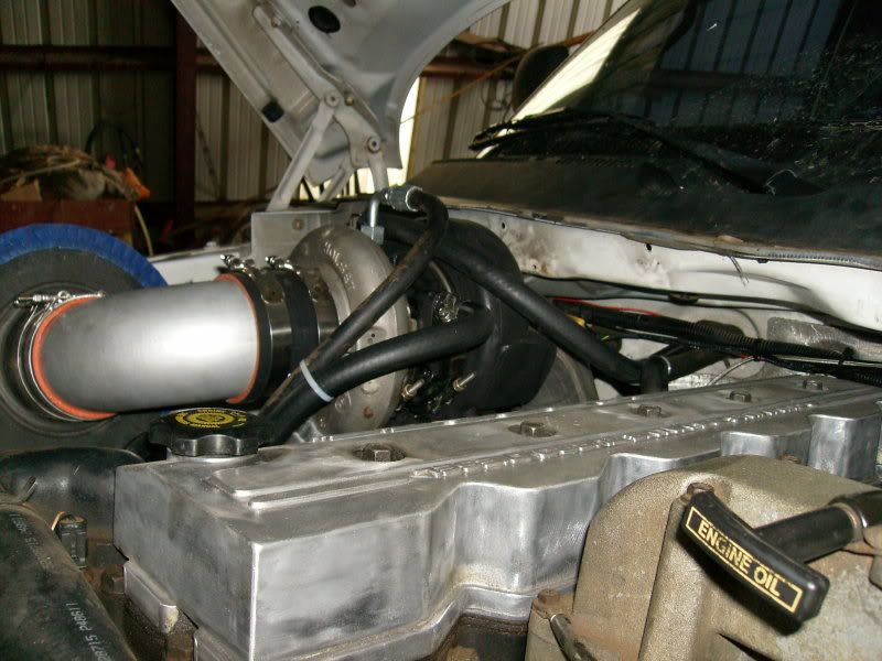

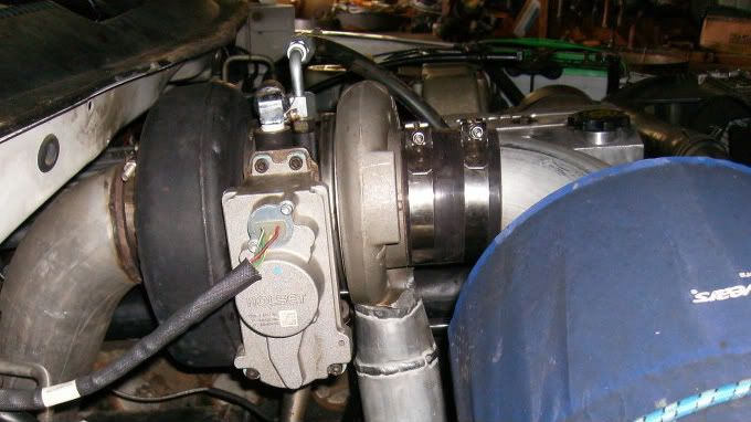

                      got everything finished up.
                      just used a 4" alum 90 on the intake

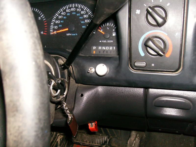

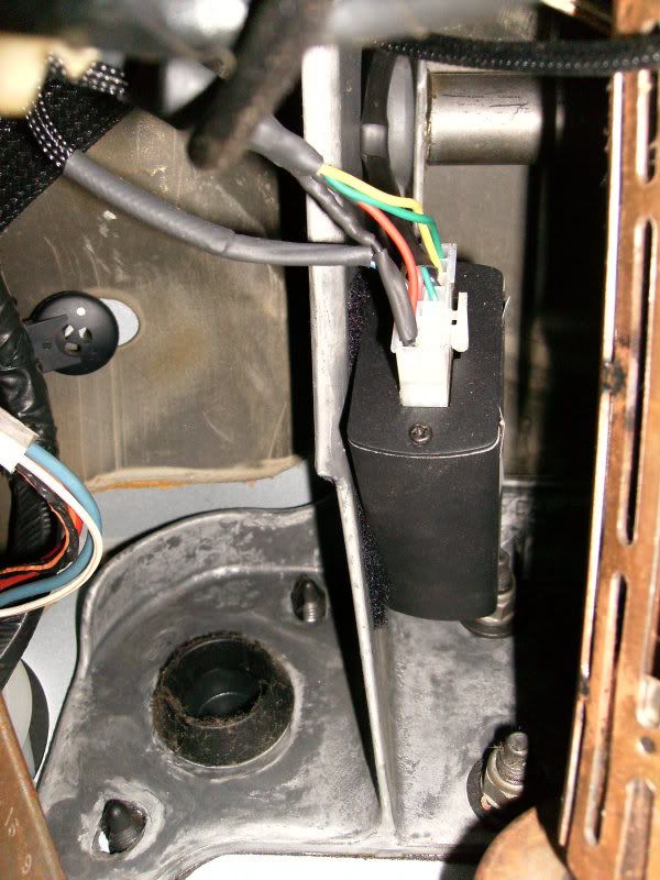

                      mounted the Fleece Controller under the dash
                      mounted the eb switch and realtime boost control on the dash trim

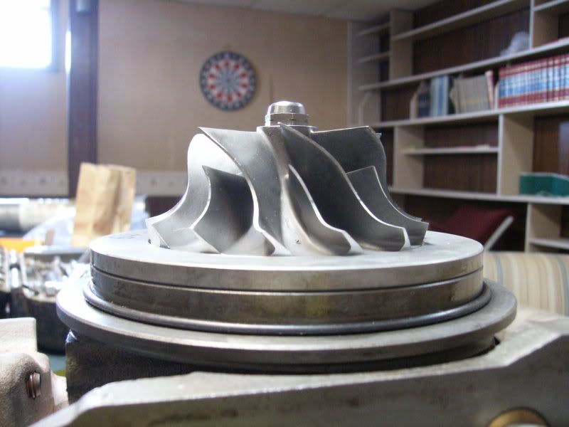

                        look what showed up in the mail today. 64/62
                        • DrifterExtremeD Offline
                          DrifterExtreme
                          so what is that turbo capable of? I'm not familiar with diesel turbo sizing. also it looks like it is Extended tip? Is that a holset wheel, if so have they always had ett wheels or is this new?
                            squawsnatch
                            700hp on a 64mm is attainable with reasonable egt's. but that would be done on a 64/71/14. not sure what this will be capable of since its the only one made. im testing it with the stand alone vgt controller for a shop in WA. the compressor wheel is a borg warner wheel. they took a stock he351ve which is a 60/60/vgt and had the housings machined for the bigger wheels which are 64/62. not usre if you are familiar with how diesels label turbos but they use the compressor inducer and the exhaust exducer and then the housing size in cm.
