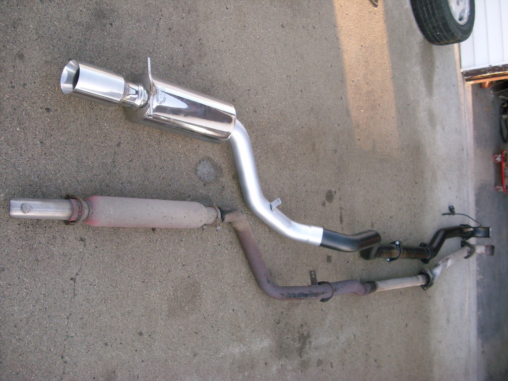

                              I installed my 3 inch mandrel bent exhaust. Sounds nice. :icon_cheers:
                              • z31Z Offline
                                z31Z Offline
                                z31
                                This is the difference between the stock down pipe VS the CM 3 inch in the area that goes under the transmission cross member. :icon_geek:
